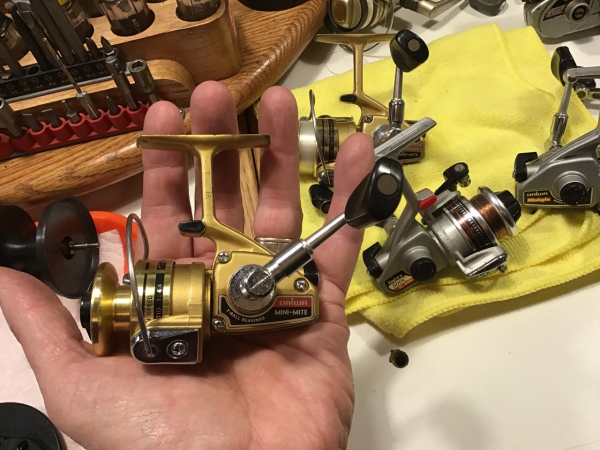

Here are a couple of Daiwa Mini-Mites in gold, with bearings.  They are true Microlites.  Top quality tiny and tough reels.
Mount one of these on a 5' to 5.5' quality glass rod — 4 pound test — and it would be hard to find a better or more fun combo.
These were introduced around 1978 — and were made in Japan.
They have gained a well deserved following over the years.  And are a very desirable reel.  Spring loaded crank handle, metal skirted spool, (2) ball bearings, high-speed, all metal bodies and casings, attractive, and only 6.3 ounces.
If you get a chance to pick one up — you will enjoy using it.  Solid little reel that will handle fish up to 5-6 pounds easily.

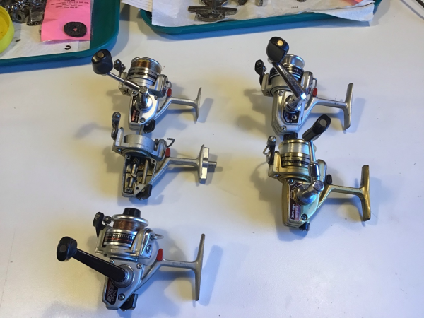

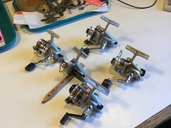

Basically, they are all close to the same, Wayne —
The 500C is the smallest, then there is the 700C, and 1000C.

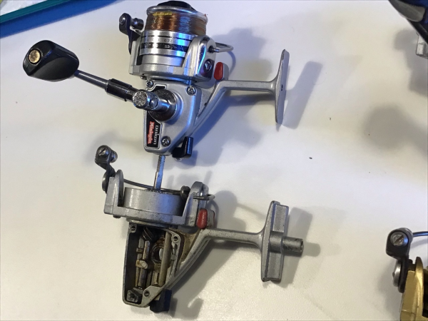

Typically, a Mini-Spin will have a vertical protrusion that attaches the foot to a special Daiwa rod.  I just remove these using a cutting wheel and hand filing — and refinish the foot with jewelers tools so that it is smooth and will fit any spinning rod.
Here are (2) Mini-Spins on top — with a slightly smaller 500C below them.
The stand shows a before and after adjustment (removal) to the stand connection.
The other two main differences between these reels is the gold or silver color.  Gold has (2) ball bearings.  The silvers have brass bushings.  Since the sizes for the bearings and bushings are identical — one could just replace the bushings with bearing — and have a much more robust silver Microlite reel.
Generally, the Daiwa reels with the attachments poking up from the stand — were offered in black plastic travel cases which included a 4 piece rod and a few lures.  The reels were excellent — the rods were between average and junk.
All great reels — and will become even scarcer than they are now — because they fish well, appreciate in value, and are simple and strong.
