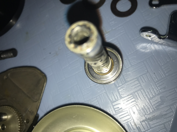

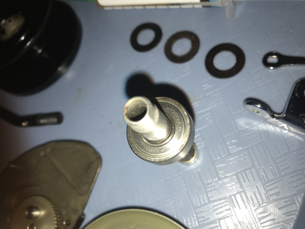

I ran into something new for me. Doing a service on a
Shakespeare 2062 and the rotor nut has a locking clip(?) on it.
What's the procedure to remove this?
Thank You for your help.
-Steve
Open end wrench to start the hex nut — then everything just comes loose.
When tightening — pay attention to the orientation of the keeper and nut as you tighten it.
You will see how it holds the nut from backing off —
