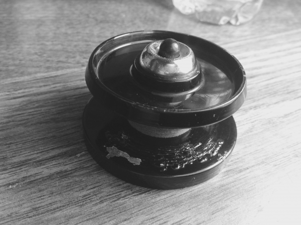

I've used this reel about 10 times in saltwater. The spool feels, sounds and looks like aluminium. There's a paint job on it, is that what some call "powder coating". What to do?
Pictures; 1) paint loss, and bubbling of paint. Note the reel: a Zebco Cardinal 6, I love this reel as an light inshore reef caster. But, notice the lable on the rotor. Not a big surprise...
2) modified photo("tonal") difficult to see, but the paint( oh man! Hopefully not the aluminium) is really bubbling.
It is just the paint, Greg —
Due to salt on the line.
Aluminum should be OK.

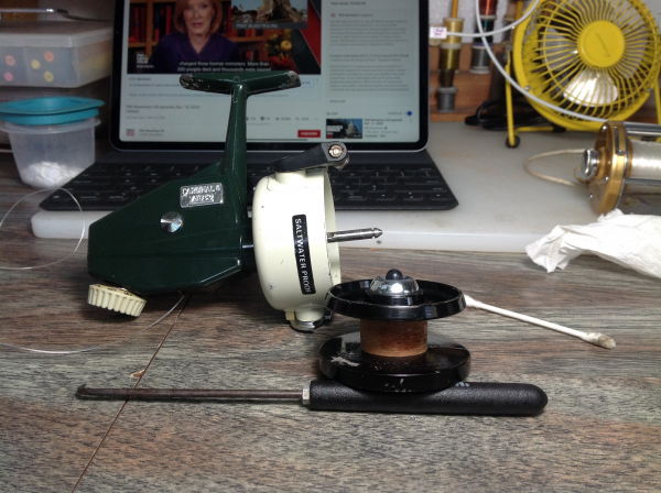

One approach would be to use an old shaft to chuck it up in a drill — the sand with emory paper or tape — then "0000" steel wool — then either paint it or leave it bare with a coat of sealer.
