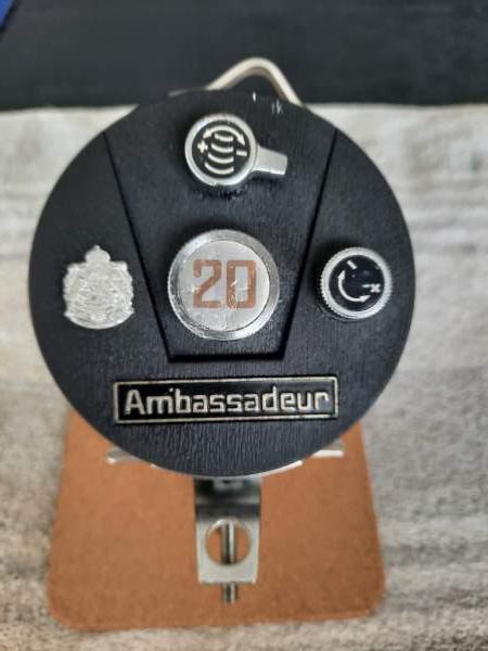

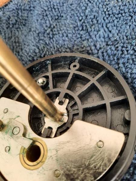

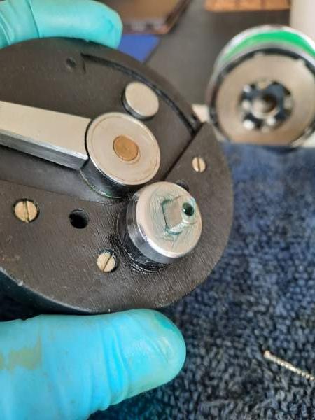

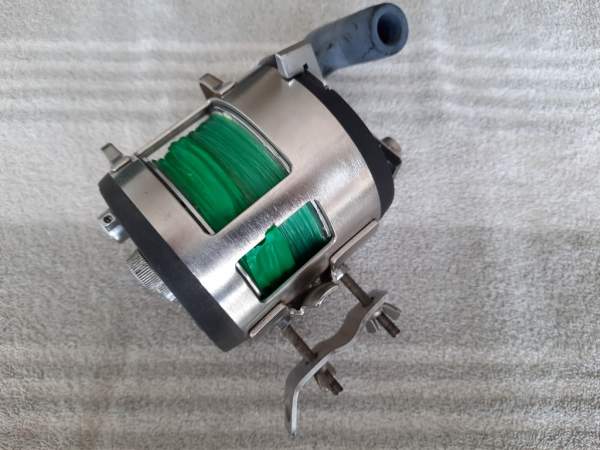

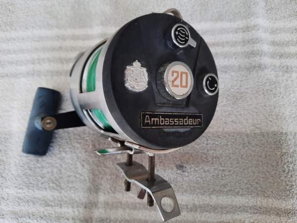

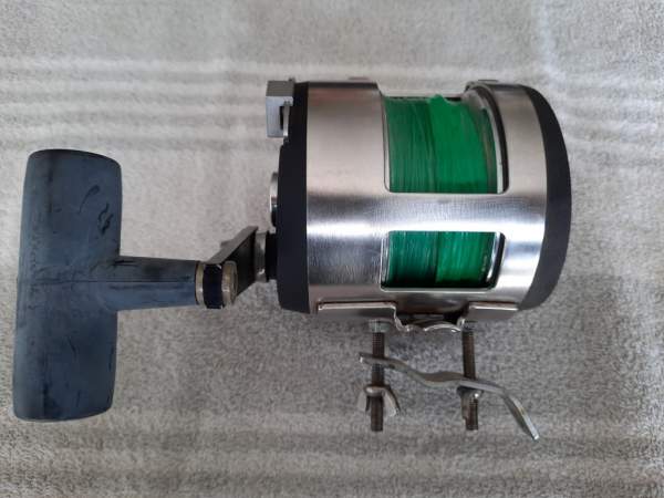

  This is a reel that gets a lot of flack in fishing forums, but I'm not sure why, as is seems to be a very well built reel. There must be a few folks out there who are in the know...as resale prices indicate...one of these in good shape brings more now than it did when new. My brother snagged this one for me as a Christmas gift, and the fleabay pics below indicate it was in pretty good nick.

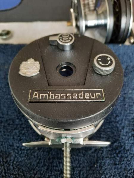

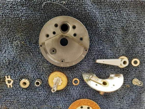

  Opening the reel, I was shocked at the components, lots of steel. If this thing is a "cheap Taiwan" reel...I'm just not seeing it.

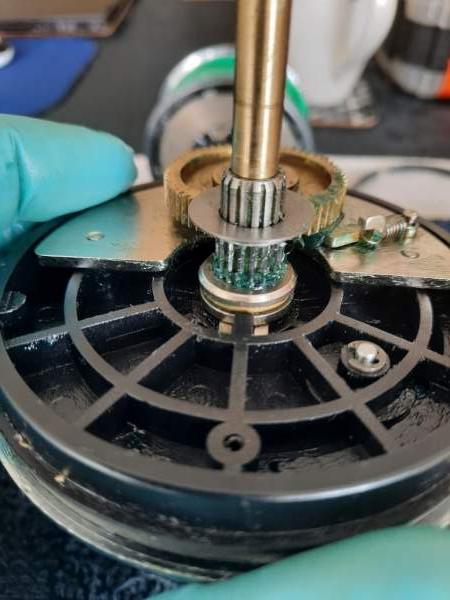

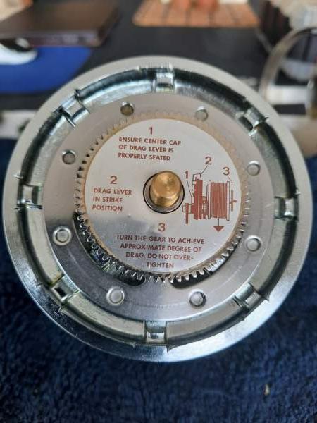

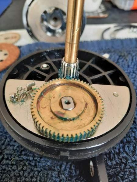

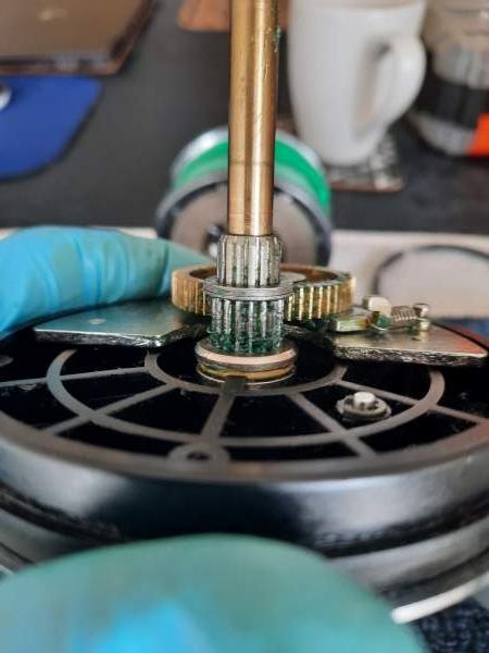

  Look at those gears! Compared to the 6500c gears on the right, it should be obvious this thing is a beast. I saw in those forums where a guy said these reels did not come with steel gears from the factory...that the steel gears were aftermarket. Then I saw ads where Abu said that it did come with steel gears. Maybe Doc Janssen can shed some light on things. :-\

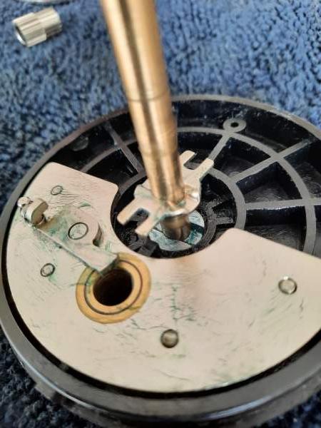

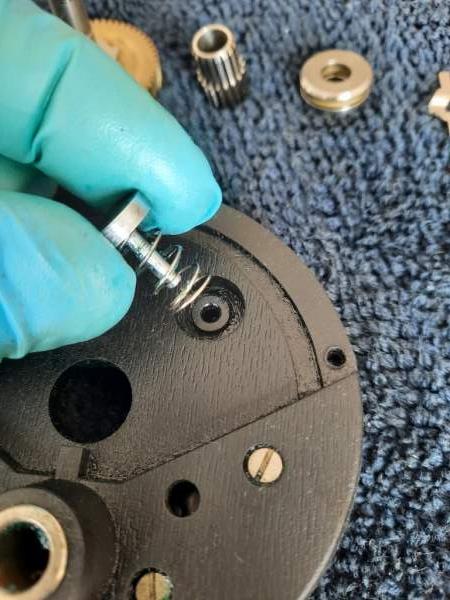

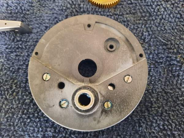

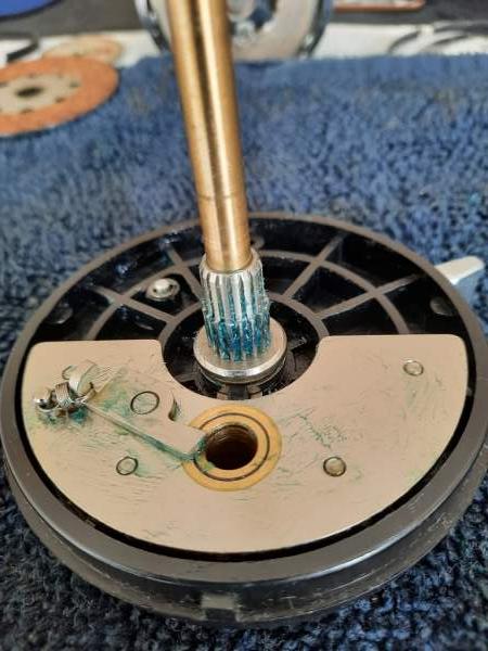

  No need for a bridge upgrade here...she sports double AR dogs right out of the box! Note that on the bottom of the main gear there is an old style drag clicker, a feature I kinda like.

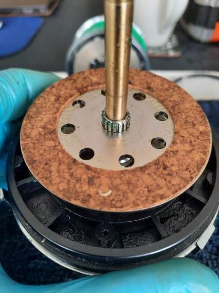

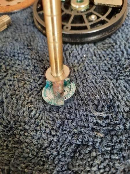

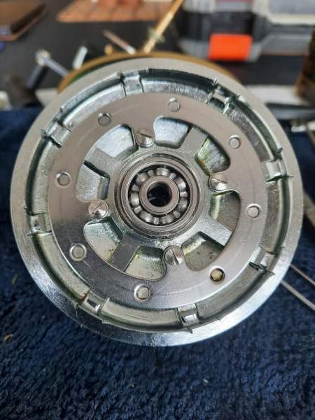

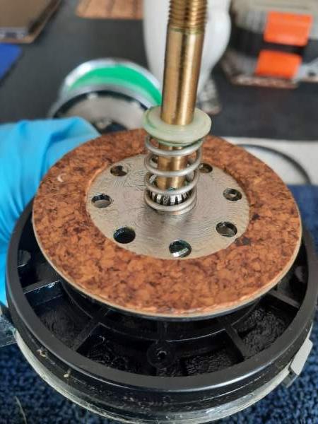

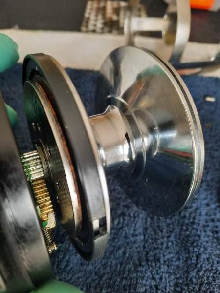

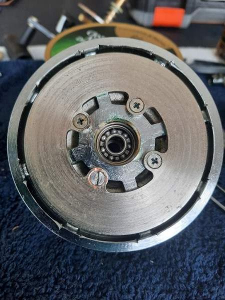

  There just isn't much brass or plastic under the hood. You have a brass driveshaft(gear sleeve) and a plastic spacer bushing. Everything else is stainless steel. It even has a 5-stack drag! :o

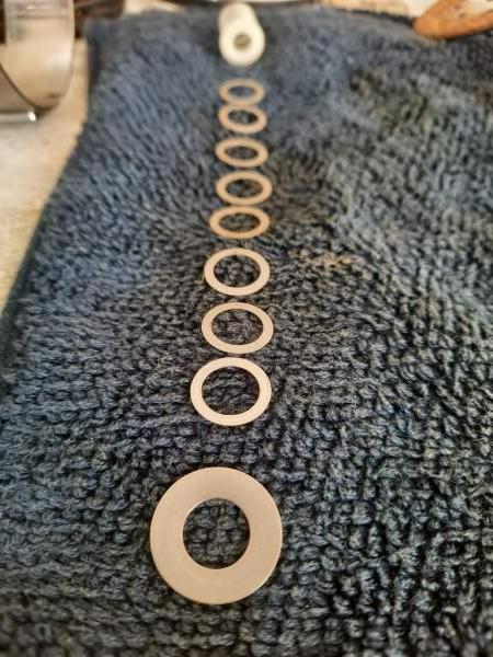

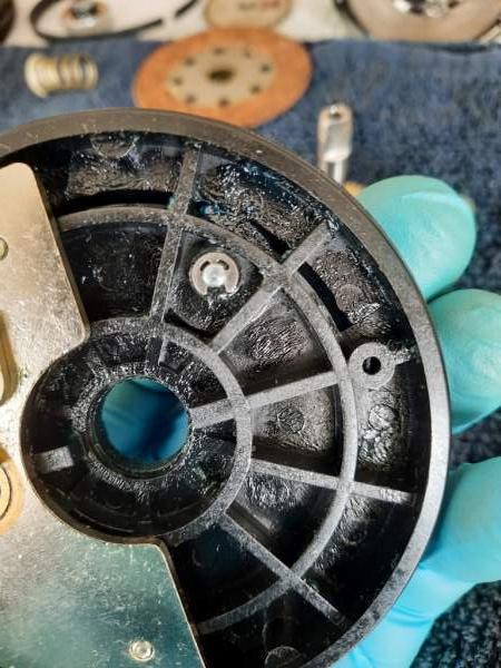

  I'm not sure what material these drags are made from...it appears to be some kind of teflon or delrin. Once again, in the forums, they get bashed pretty hard. The googans all say when they get wet they stick. This does happen with teflon...kinda like trying to scoot your butt across the bath tub...it chatters. I greased the drags with Cal's purple and they work fantastic. The grease should help keep the water out. I lost about 5 pounds off the top end, but I prefer 15lbs. of smooth power to 20lbs. of chatter.

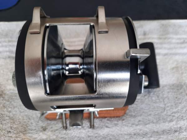

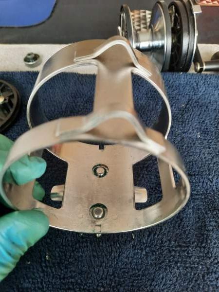

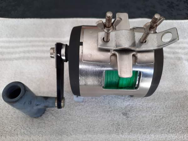

  The frame is your typical Abu type cage, but it does have 6 screws on the stand, and the cross bars are pretty heavy too. I tried to twist it by hand, like you can do with the little 5500/6500, but it definitely feels more solid.

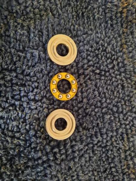

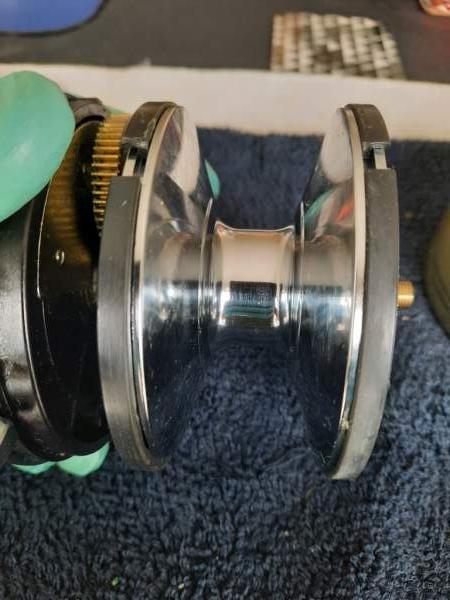

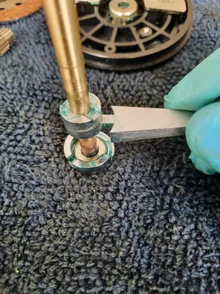

  The spool has a nice heavy shaft, and the bearings are entirely different sizes.

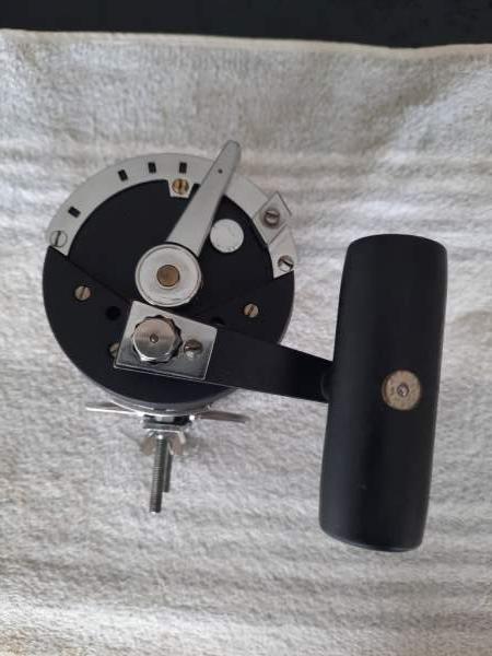

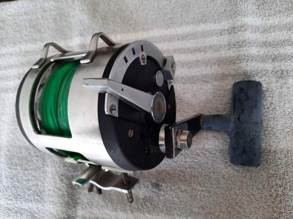

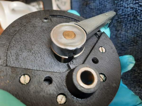

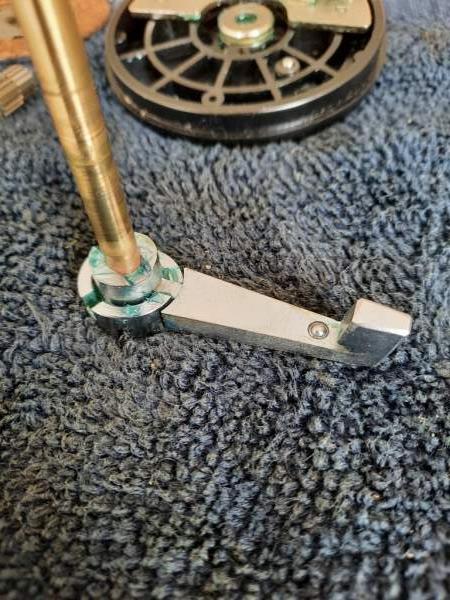

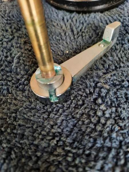

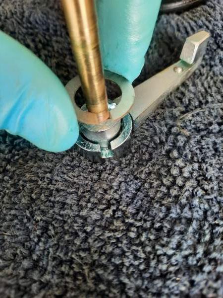

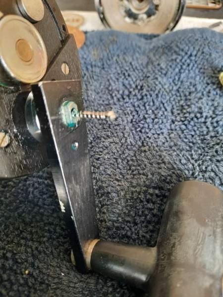

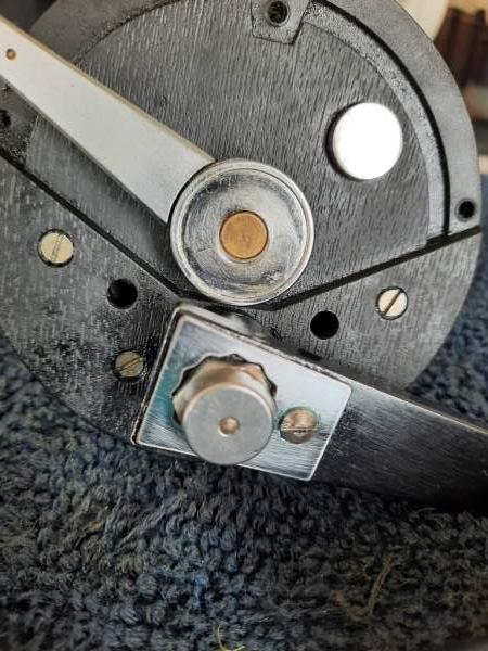

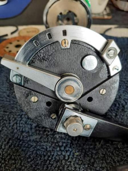

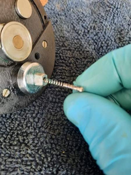

  You'll see a lot of these reels missing the rubber bumper from the shift lever. Three tiny o-rings make a perfect fix! ;)

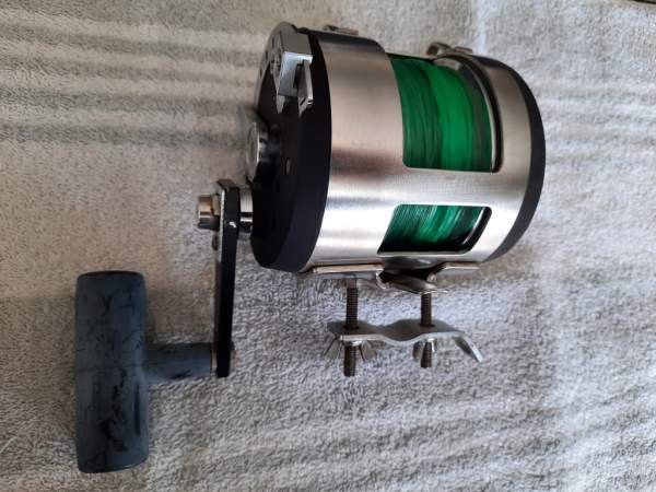

  The finished piece sure is a looker, and it has all the muscle to walk the walk. 8)

   With a set of Dawn's CF drags...yes...this reel will make 20 pounds easy. Abu claims the stock drags will make 20 pounds too, but I can't deal with the top end chatter, so I sacrificed a few pounds by greasing them. It's a wonder they made any power at all...what can possibly be slipperier than greased teflon? ;D

Nice build as always Mo - and the 3 O-rings to replace the bumper on the shift lever - that's genius!  I will probably "borrow" that idea in the future... - john
