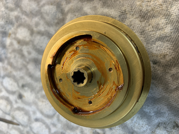

How does one get access to the drag plate/washer on this reel?
There are no screws to remove the cover?

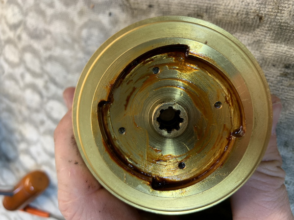

there are three parts here - the spool, the drag pressure plate and the cover.  if you muscle it, the cover should rotate.  look carefully and you will see that the cover has three tabs.  you will leave tool marks, but a small screwdriver can be used to pry up the tabs.  sometimes a plastic wedge will work, sometimes not.
on the first photo, i can see the tab at the 2 o'clock position.
you will likely have an asbestos drag washer in this reel.  the replacement part for the entire plate is $95.  there is a possibility that you can replace just the drag washer for $30.  check out these.
https://www.mysticparts.com/PennParts/Parts/6A-30.aspx
https://www.mysticparts.com/PennParts/Parts/117DN-70VS.aspx

Winner winner chicken dinner.   That did the trick.  Thanks
