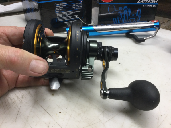

Made it down to Charkbait this morning for the 20-70% sale. Picked up a Fathom 25NLD2 and a 40NLD2.  Couldn't wait to put them through their paces.  Now I will admit the lever drag and 2 speed is all new to me, so setting the pre-set and drag is taking a while but here is what I'm getting so far without any pre-service.  Take a look at the photographs to see what I'm talking about while moving the lever drag....
25N is giving 3lbs at #1, 4 lbs at#2, 8lbs at #3, 11lbs at KE (last 2 letters for "Strike"), 12lbs at RI, 18lbs at ST, and 27lbs at Full.  Free spool with an empty spool was 1 minute, without cleaning the spool bearings.
40N is giving 5lbs at #1, 11lbs at #2, 17lbs at #3, 23lbs at KE, 24lbs at RI, 26lbs at ST, and maxing my 27lb scale at Full.  Free spool with an  empty spool was 1:54 minutes, again without cleaning the spool bearings.
General observations:  Both handles seem to take a little effort to turn, when compared to a Jigmaster, when set at strike.  Not much, but not as free as a Senator or jigmaster......maybe too much grease in the gear case? The effort is almost nothing in low gear.
When levering from Strike to Full takes a little effort, again not much but noticeable.

  What your feeling is completely normal with most all 2 speed reels when set toward the higher end of their strike range. The 40N Fathom in my mind is a reel for 60 just barely. But what do I know I've never been fishing where your going. Many use it for 80... Jeff

Like Jeff says, there should be some handle friction at strike, on a 2-speed LD in high gear. Also should be some effort on the lever going from strike to full(sunset). Interesting the diffrence in spool spin times between the two...check the "pre-set" drag range when testing, both set at the two extremes(loose & tight) for their prespcetive drag ranges, i.e. set both at low drag range, test 'em,  then both at high drag range and test.
