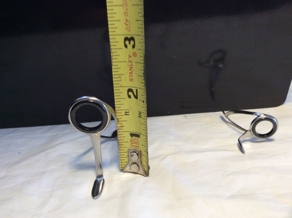

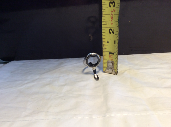

I don't use spinning rods much but I've been going to smaller stripper guides on my personal rods. I'd go smaller still but finding tall enough guides for the stripper guide is an issue.  One outfit here is starting to make tall frame guides with small rings for heavy salt but I haven't laid my hands on them yet.
Look at the Fuji Low Rider LC 16M, the M version is taller than the standard. There is also a 12M, but obviously not as tall.

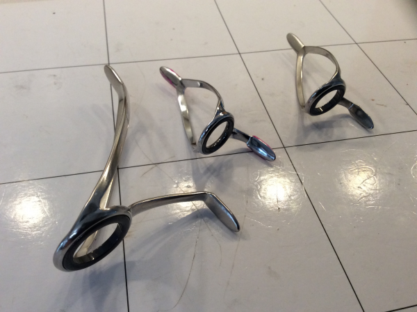

  While we are still training the line , i remembered these pictures that may be interesting .
JasonGotaProblem
Joe that double guide pic is giving me anxiety.

   That double guide may work ,but i think it needs a little more space between the two .  I have not played with this set up .
