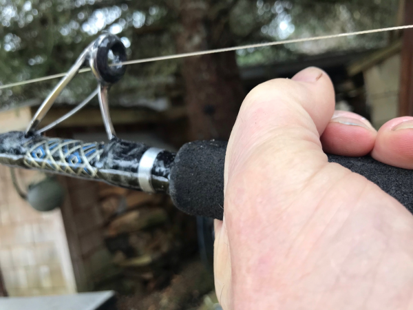

Thanks for sharing your thoughts.  In the picture you can see the hand grip the rod and the clearance needed for the application in mind.  Moving the first guide and or using a less tall guide reduces the clearance
  This is to answer Wayne's question hopefully, and it's a solution to the earlier problem of having the line cutting into the foregrip or your wrist in stand up fishing 🎣.  Thanks for your illustration.🐟
  As to help Alex understand what was done at the stripper guide shown a confession must be made.
A size 10 guide was trimmed of its feet and JB welded to the size 20 and offset as much as possible.
  This is experimental and did work to keep the line in the center of the reel with no mending. Waay better than the test with the factory 20.   Yes a 16 is just somewhat the smaller twin sister..🤔
  In a spiral wrap rod this is the biggest problem I've seen as there is nothing tall, somewhat sturdy, with the small diameter ceramic that I'm aware of.
  Roller guides aren't designed for any side load,  The Aftco graphite stripper Wayne showed us, does have a titanium side plate and is quite tall.   Butt so is he.😻
    Tall narrow reels will help to keep the line off your hand,   So maybe the combination is something to consider?    I have not yet accepted the idea of cocking the first guide to the right in order to go left in the transition layout.

I feel like I am missing something here.   I say that because the problem that you have is the line touching your hand when under load.   I accept this may become serious on a long fight with strong fish and perhaps more so with braid.
All my rods and most of my friends are built with the reel on top and a fairly long gap between the reel and the first guide.    Although I go out of my way to build a rod in a way that will keep the line away from the but or a hand as much as is possible, quite a few of my rods have line cuts on the front of the but.     Proves that it is not always successful to achieve that goal.
Now here is the thing I don't understand, I have never really had my hand cut or even hurt by line touching it.   In fact it has never really bothered me that I can ever remember.   Why is this?
I can only think it has to do with the way in which we fish.  Maybe its the way the Halibut fights, I unfortunately have no experience.  I move and swap my hands a lot when fighting a strong fish and also open my hands by keeping my thumb away from under the line, as in the photo.    Perhaps my rods are stronger in the rear and thereby keep the line away, but I've already said that some do touch my hand sometimes but I guess it does not really bother me.
Cornelis
Yes.  Thanks,      Your picture shows that the rod is simply laying in a cupped hand.  If a harness, gimbal is used it seems that this will work.   Off times the heavily loaded rod is handed off to a guest or helper to get around obstacles,  things get out of control quickly.
  The height of the guide is half of the quest.  For spiral wrap rods the transition from top to bottom of rod should be in as short of space as possible to get the full benefit of the change in dynamics.
  It seems?🤔🐟🤔
