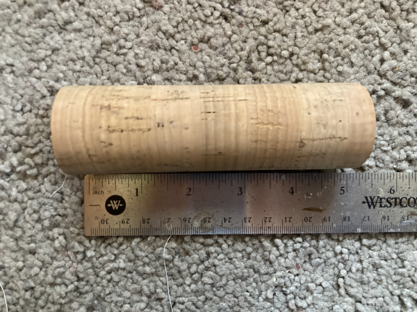

I use cork on my personal rods even the fat ones. I use these, about 5" long so no clamping and plenty fat enough for most blanks.  I'm going south to get some supplies Saturday, I could grab some and send it to you if you want
That's awesome i will take you up on that. i haven't been able to find it that wide. PM me the price and your PayPal address. I'll just save this handle for a narrower blank.

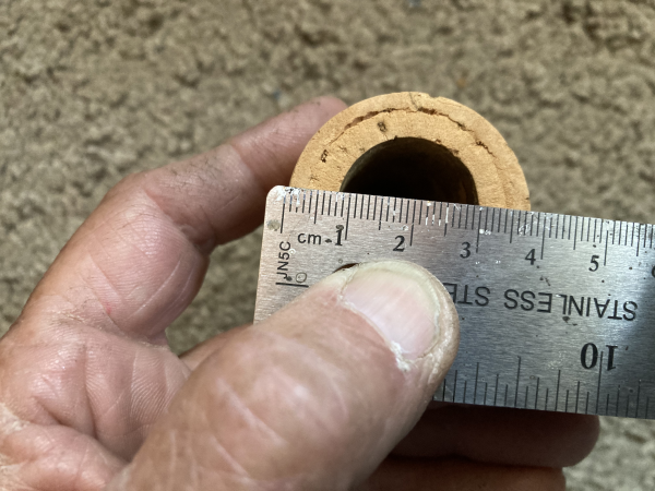

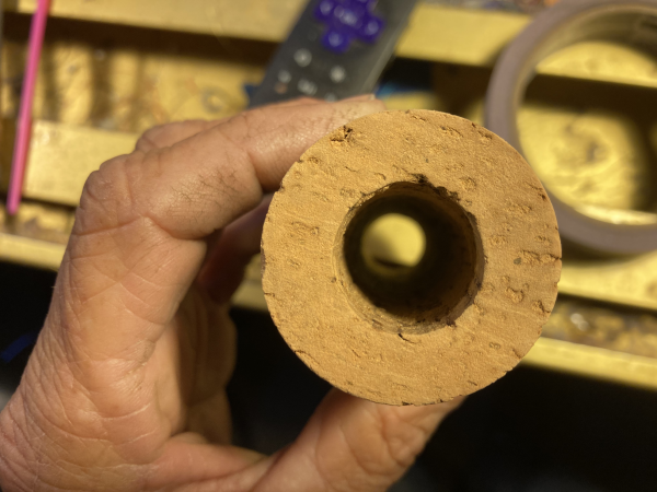

Are those two piece, one inside another? It sure does look like it.
It's one piece.
I get them from island tackle in carson CA.  I've also gotten them at Bob Sands tackle in Van Nuys ca.
I though the same thing looking at it .
It does look like 2 pieces but I don't think it is.  Here's the other side

That is some good looking cork.
The large diameter solves the problem for reaming.  But perhaps a problem still remains if the goal is a smaller outer diameter grip on a fatter blank.  I would start to get nervous if the cork wall diameter gets under 1/4" (~6.3 mm), but maybe could push a bit with extra high grade cork.  Natural cork has voids, actually wears  down and takes significant torsional load (because it is so grippy).  It  does not seem to me to be an ideal material for a long lasting thin wall grip, especially if you are not gentle on your gear.
