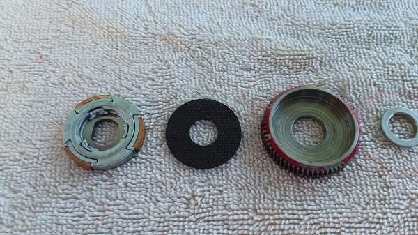

Okay, here are some details of the Triple Thruster drag. The box claims 55 lbs and I have not tested to anywhere near that but it seems pretty smooth at 12 lbs.
Notice that there are no ear slots inside the main gear. There is a carbon washer (dry) under the main gear and another (dry also) inside the main gear and under the Triple Thruster assembly.
The Triple Thruster functions like drum brakes rather than the disc brakes that are so familiar to us.
The brake shoe material looks like some sort of plastic but I didn't test it at all and don't know anything about replacements. I'm assuming the entire assembly will require replacement if it wears out. I did pull one of the shoe surfaces off while pulling it to see how it woks. I'm not certain if they attach with adhesive or if they just sort of snap into place like a dove-tail. There's not any instruction manual included.
I ran out of time and had to button it up so I haven't had a chance to compare the internals to Newell. The main gear OD is larger than a Newell 300 series main gear. Also, overall frame diameter is larger than a 300 Series but Smaller than a 500 Series. The clicker assembly looks like Newell from the outside but is completely different on the inside. The inner rings have plastic (composite?) inserts that attach with small screws so they are more complex than Newell. I'll do side-by-side photos when I get around to a pre-use service before fishing it.
In all fairness this reel is brand-new and not broken in at all. I do suspect that the 55 lb drag claim is an error on the packaging. I did pull on a spring scale a little bit and 12 lb felt pretty smooth. It ramped up to 20 lb real quick and the line broke so it was probably locked at 20 and that's where the 30 lb mono let go. I'll spool braid on top and find out what it will really do. I would love to hear Sal's opinion on this drag system. Seems like there's not a lot of friction surface and I wonder how hot it gets. I read reviews that state that it handled 25 lb yellowtails. I would love to see photos of how the drag looks after a good work-out.

Very interesting concept in you have the conventional Flat friction application and then the Cylindrical 3 shoe brake which is pretty darn neat as it would apply equal contact all round where your 2 shoe system the front shoe does all the work .
I bet it would go 55 lbs and those shoes may be some sort of ceramic? Which would actually fade a lot of Heat.

I don't think the brake shoes are ceramic as they flex a bit. I had to do this to get the shoe to snap back into the holder.
The drag ramps up to 12 lbs pretty smoothly but then gets hard to turn the star and the curve seems to go straight up from there. I ordered it with 30 lb mono (complementary) as I thought it was equivalent to a Newell 300 Series, It's actually a little larger. I don't have a 400 Series to compare it to.

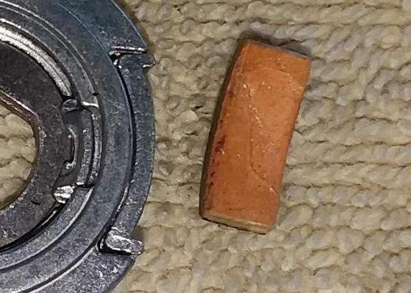

These are what I was refering to as 'brake shoes'.
I accidentally pulled one off while I was checking out the Tripple Thruster drag assembly (Part no. 17). It felt like it may have been glued in place so I was going to re-secure it with superglue. It feels like plastic but I have no idea what kind.
Here's another view. It will snap into the drag assembly without glue and hopefully it will remain captive and not become loose in there. It may swell and shrink with heat and wear down over time. We'll just have to catch some big fish to find out.
-Mike
