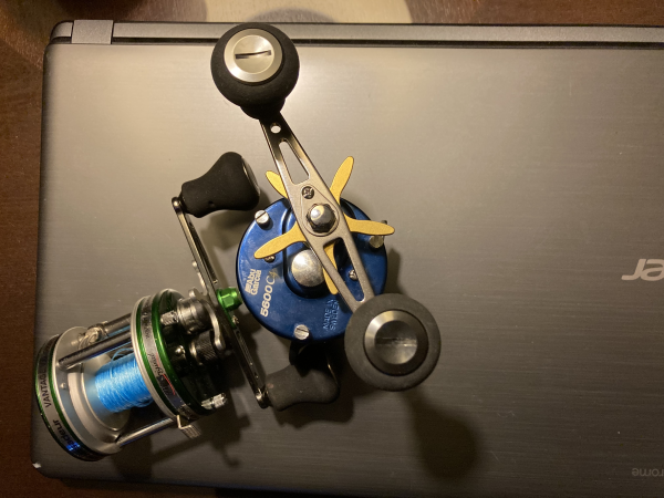

I own a bunch of Ambassadeurs and serviced alot of different 5-6000 series, but never seen this kind of anti reverse dog or top metalwasher in the dragstack. Also a screw instead of c-clip a the top of the mainshaft.
Looked at all my schematics and couldn't find this type.
How could I have missed this type?

Hi again! Does anyone know where to find the right schematic for this reel. I don't know but I think some shim/washer is missing. The antireverse dog comes vey near the maingear and sometimes makes noise? Its like tip a bit forward/down so there becomes a small gap between the antireverse dog and the bushing its mounted on.
Wompus Cat
Looks like from the photo the pin on which the bush and dog fit is bent out away from the main gear a smidgeon and that's all it takes on one of these . You might try bending it  a bitto center it better  to see if it gives you the clearance you need . Otherwise you may need to place an additional washer under the main gear .

Wompus Cat, good eyes there ! Its a little bent. Thanks  :)

Lunker Larry Thanks, will see if I find the right one for this 6000C with a 3 piece antireversedog I've never seen before. Just to compare if it needs some shim or washer.
   Wompus Cat is correct, those dog posts on this style build are notorious for bending or breaking. If you look at it close...yours appears to be lifted off the plate a bit...it should fit tight against the plate. Here is a link to a post where I fixed one of these. Sometimes it works, sometimes it doesn't, you'll just have to try. 8)
