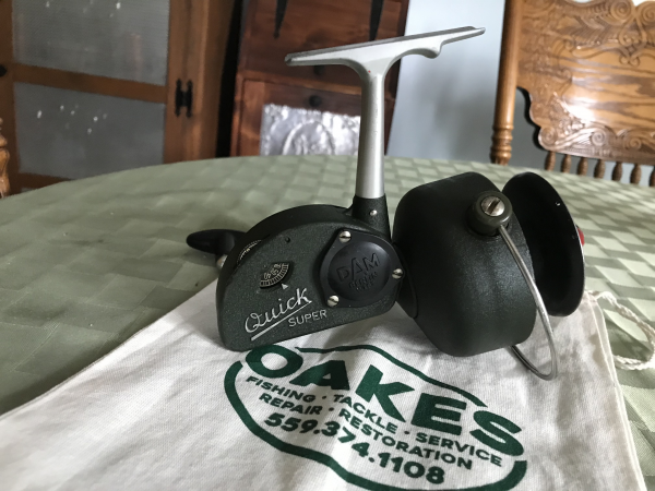

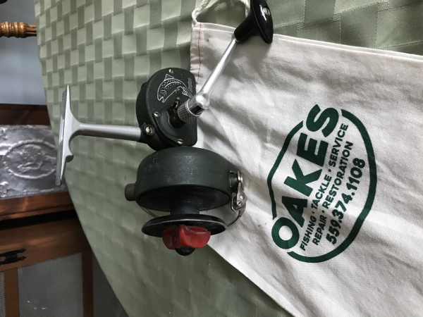

Randy Pauly of Vintage Offshore contacted me a couple of days ago — asking if I had any Newell clamps.  Said he had an old DAM Quick 275 2-Speed reel (one of my favorites, and a rare reel) to trade if I had any Newell clamps.
Told him I only had a couple — but I did have a box of new old stock Newell parts that he was welcome to.
Exchanged photos — made a trade — sent off that afternoon.
Randy also said that he was going to include some extra spinning reel goodies for me.
Today, the reel shows up — and there is a goodie all right — another DQ 275 2-Speed reel!!
Thanks Randy!
