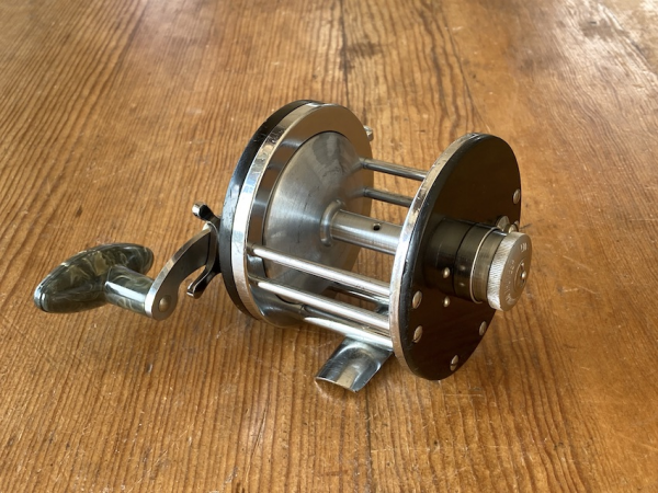

Not too many Bronson/Coxe reels on the site here it seems. I kinda like them, from my freshwater collection, and have acquired a few saltwater models that, as I have time, will post.
This one, the 1115L is listed in B/C catalogs from '48-'53, as a 150yd "light surf-casting" reel with freespool, Bakelite spool, and no internal drag. Not much cleaning up to do in this one as it's darn simple: No drag washers, no AR to attend to. The main gear being a solid chunk of brass. And this one's in rather minty condition. Apparently, she didn't see much fishing time. Internally, some dry grease, and not a lot of it.
Important parts polished up nicely. Easy on the lubes: Synthetic SuperLube grease for the gears and SL PTFE oil for the shafts. She spins nicely and quietly. Kinda neat having a 1950's reel darn close to the way it would have been out of the box. I hope to put it to work and slime it up someday. :) I may make an aesthetic change though, to a 1930's wood-knobbed handle if I can find one that will fit. Not so keen on the current white plastic knobs.
I have a particular interest in DD, thumb-controlled, casting reels. This has now carried over into my new saltwater "collection", and may prove masochistic on the water. Guess I'll have to decide just what I'm willing to cast to! :)

The clutch is unusual.  Is it some sort of yoke and ramp to disengage the pinion?
I suspect it is too large for my needs but if it is ever convenient, please measure the side plate diameter (roughly).
What is the width of that square hole in the handle.  It may be compatible with some other brands.
Oh, and what is the spool made of?.... please
I don't know clutches well -yet! But yes it acts as a "ramp" that lifts to disengage the pinion. Same general design as on the 325L I just wrestled with, but a bit larger and of a different metal (steel?).
Of course: Plates I measure at 2-7/8". Pillars are 1-11/16". I'd weigh the reel but my scale is packed away. The ads I can find don't list much data, although I think I've seen that somewhere. Guessing it's around 13oz.? It would make for a large FW reel.
I measure 5/16", both the hole and sprocket.
Bakelite
