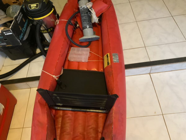

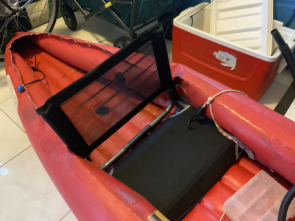

Here's what I put in my 1st yak, a 10' inflatable. It's a portable stadium seat sold by Costco. Will eventually corrode due to the cheap metal and finish, so it definitely needs a post-use rinse ASAP, and does need lube on the hinges. Good support though when compared to the inflatable seat that came with it. Relatively easy to secure and adjust if you go crude and cheap like me.
This kayak is 22 yrs. old now and has numerous pin-holes that I patch and then cover with duct tape, once/year. Lotsa great memories with this baby.
