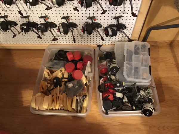

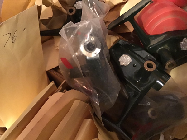

I likely have the spring in my ABU/ZEBCO parts, and I also have new frames with the tensioner. But Tom may have a better fix that won't be so involved.  He is the Cardinal Expert.
I have 14 crates of NOS ABU parts — and have not had the time to go through them yet.
That will not be a hard chore — since everything is basically numbered and enveloped or bagged in order — but I need to find room for them to live here.

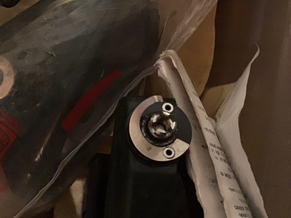

It is a must have, otherwise your drag knob setting won't stay where you set it and will change easily. Worst case scenario is you'll lose your drag knob & screw, fairly easily, actually. They're usually attached with two rivets unless someone revamped it. There used to be an aftermarket hard rubber replacement but I haven't seen any of those around for a long time. There's also a partial tensioner like the one in this photo (Part # 11107 C3 or 14605 black C3, 4 & 5) that will work on the green or tan 4s but you'll need to find a screw & tap the body.
Rusted doesn't really matter but you need to clean the rust off. Broken depends on where it's broken. A couple good photos would help determine an appropriate fix but as long as you can create bend/hump that will have pressure in the notches inside the drag knob you should be OK. I've done that a few times and it works just fine. I usually remove the shorter portion. It ends up looking similar to Fred's last photo. Just make sure your bend/hump has an extension and smooth top so it rides nicely in the drag knob.

The last Zebco and ABU tan Cardinal 3s ('78 - '81) had the half circle (#11107) with the screw. Also, the last version, 1977 & after, Cardinal 6 & 7 & the 6X & 7X had them with a screw (part #4093). The screw is the same for all of them, part #78.
