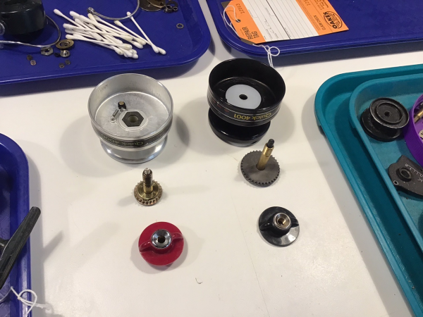

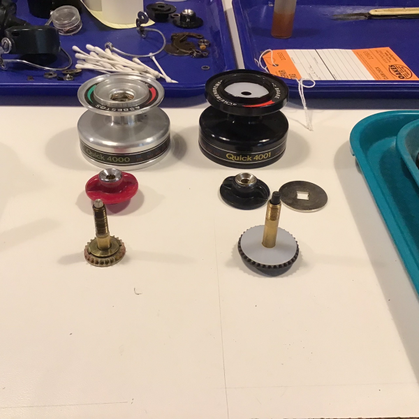

4000, 5000, 4001, 5001
Although the 5000-5001 will do the job — I think it is a little over-kill.
4000 — 4001 would be my choice.  The drag system on a 4001 is slightly better than a 4000.

The 4000/4001 are good sized reels with excellent spool capacity.
