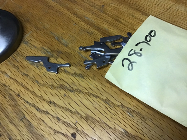

The rotor spins freely when the bail is closed, but drags terribly on the inside of the stainles bearing retainer / bottom rotor cap when its open and until its triggered. I want to file the little nub down on the bail release arm but I dont know why its there. There appears to be some small "hump" in the stainless bearing retainer / rotor shield that "might" assist in raising the bail arm to be tripped by the larger of the 3 bearing retainer screw heads, but im not sure. I know its not supposed to be rubbing. The nub in question is cast with sharp edges and it seems unlikely that contact between the bail arm and the stainless bearing retainer / cap is intentional
Is it OK to file this down until it spins freely with the bail open? Anything I should be aware of? These bail release arms are pretty hard to find replacements for based on a cursory internet search so I dont want to destroy it due to ignorance.

Hi Tyia —
These old Heavy Duty large Spinfishers like the 700 & 704, 706 — generally get some pretty hard use over the years due to fishing conditions, salt, and large fish.  So parts do wear out.
However, on that bail release arm (28-700) — that nub is designed to be there.
My procedure would be to fully disassemble the rotor assembly — then clean all of the crud out of the crevices until the nooks and crannies were as close to original and new as possible.
Then check to make sure that the SS under plate, bearing, bearing retainer, (2) retainer screws & the (1) larger trip screw are all seating properly.
Then determine exactly where the rub is coming from.
The slight ripple in the SS back cover is supposed to be there.
If it was not rubbing before it was taken apart — then it is just a reassembly issue that needs adjusting.
If it was rubbing previously — then it could be the shield, warped back cover, bail release spring, bail angle lever slot worn, loose pivot pin at the bail release lever, etc.
A good way to determine the rub after cleaning and reassembling — first take out the trip screw to see if that stops the rub.  Sometimes, all that is needed is a new trip screw — or slightly micro file the top of the screw to remove any goobering of the slot that might stand a little proud.
If that is not the issue, and everything is cleaned properly and also seated properly — then use a little peanut butter or a very light coat of grease inside the shield and on the bail release arm to determine where the rub is — then adjust that.
I would not file off the nub on the bail release arm.
Let us know.

Great advise, I'll set about taking everything apart and see what interfearnce remains after its clean and re-assembled. I honestly didnt check the bail function before now as it had a cracked main gear with a broken pin. I didnt check bail function until after I installed the new gear that came in the mail yesterday. Based on the severity of the rubbing on the stainless steel bearing cap I would strongly assume it has been functioning this way for a long time

Hi Ty —
The fact that the gear was cracked — also leads to the fact that this reel was put through some hard use in it's previous life.
Something very well could be stressed, tweaked, bent, or out of adjustment.
No big deal — the culprit will become evident after you clean it up as good as possible — then carefully determine the cause.
Again, keep us in the loop.
