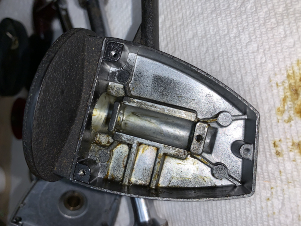

Now, I need a bail spring for this reel. How shall I order?

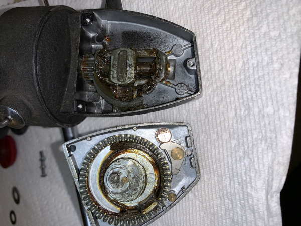

Do members like this 247 to fish with?  This one is seemingly a Frankenreel.

Yes. Under the spool. And the clicker thingydingy gear sleeve is all worn and bent. Not really sure how that goes. Would love to know if their are schemAtics of this reel. And I apologize for calling it a Frankenstein reel. When I opened it there was no sign of any water penetration nor any corrosion. It appears to never have been opened.
 The spring and washer goes  in the front side of the spool.
    Sandbar has the zip PDF D.A.M. Quick Schematics 2021.zip files in the above pinned post

I will do so shortly. First I have to wait for you to wake up on the west coast and answer a few questions. O maybe oldmanjoe or others will know. My 247 has a 248 spool on it.  and all the washers at the top are missing, thanks to the schematics I viewed on sandbars post. it is obvious that the spool had snapped in half right through the middle and the cork is missing though I'm not sure the filler corks were used on this model. I feel like I should just replace the spool and get all new washers just to be safe. I have the spring. I have the two washers that go below the spring. The clicker gear where it engages the shaft is beat up and doesn't engage the tiny crossbar. Pictures below.
