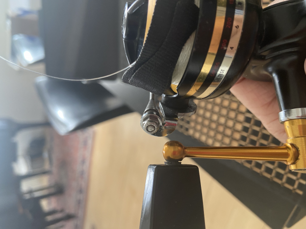

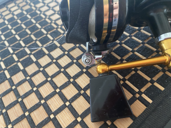

430SS & 714Z main gears will interchange.
The oscillation is the same and both work.
The problem — the A/R Dog assembly is different.  The 714Z has the traditional dog with a separate dog spring and the ratchet wheel attached to the main gear is flush to the main.
On a 430SS, the ratchet wheel is slightly set above the main — so that the friction-type dog ears have a place to be.
Gears work fine and even the 716 & 420 share the same as the 714 & 430SS.
But the dog will be problematic — anything can generally be adjusted to work — given the right amount of finesse, filing, making up springs, or high explosives...
If you let us know what you are trying to accomplish — maybe we could help with the right parts.

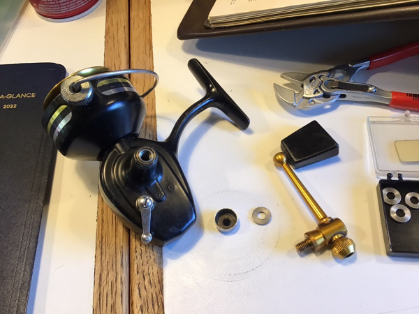

Yeah, there are different transition versions, Mike —
The (3) reels I did swap fits in earlier today — had both types of A/R's.
