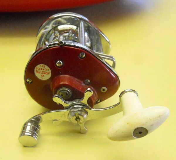

Quote from: JasonGotaProblem on March 17, 2022, 09:25:52 PMThis might not be the thread for it but has anyone attempted a flip down Aperture on a level wind assembly? Something that can be active on retrieval and out of the way for casting. I can't be the first person to think of this.
Ocean City 944 and  945 Kinda does that in that in Free Spool The Level Wind goes in NEUTRAL then back Engaged when you put lever in retrieve.
Bout 1960 ish.
