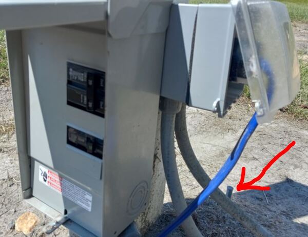

I have been looking at videos of wiring the grounding rod, and one said to bond the breaker box cabinet to the neutral bus bar, then run a wire  to the ground rod is that correct? In the beginning of the install I had a 230VAC GFIC in the shop feeding the power pole at the pond and it would trip immediately when energized . I returned it, the new one tripped as well. So I had to use a regular 230VAC breaker to get the fountain to work. I read a shared neutral might cause this, could bonding the safety ground to the neutral buss bar solve the GFIC issue. I know neutral to ground already reads continuity , I have just never had to do this? I don't get the shared neutral statement, am I  missing something (brain fart) ,if it's in parallel it's the same point electrically speaking. Any real live electricians out there? I attached photos of 230VAC breaker in the shop,230VAC and 115VAC breaker at the pond, and the outlets for the fountain and the lights.

Hey James, Is this a ground rod at the pond? If so, what's it connected to?
I watched the video and it's okay but there are quite a few things I would do differently. I was discussing your situation with a coworker today but we got distracted with work. I'm not good with code because I don't do electric services every day (I hire a sparky). I can and will give you some good advice once I get all the details sorted out.
The video looks okay for a common residential service panel BUT, because you are in FL and you have a big open space with electric circuits (underground and underwater)...you probably want to get better 'earth' than what he is making with the 10' ground rods x2. I'm not an electrician but I have done lots of ground testing and have seen empirical results and know what works best.
I believe residential code would like to see 25 ohms to earth on a ground rod. But if you don't achieve that on the first try, the code only requires you to drive a 2nd rod and walk away. Our customer's equipment requirements can be 5 ohms or lower so we have multiple strategies to help us achieve that.
I'll point out the stuff in the video just for everyone's knowledge. 1) Don't put two 10' ground rods 6' apart. This is a waste of copper and will not improve your resistance to earth. The rule of thumb is to always separate ground rods by 2.5 times their length. This is so that their 'spheres of influence' don't overlap acting like just one rod. Even better is to get rods that you can couple and drive 10 - 30 feet of rod. Drive 10' of rod then screw on another and drive that another 10'. This will significantly lower your resistance to earth which is important for maximum efficiency of your SPDs. 2) Those pipe grounding clamps in the video will rust and get loose. I replace these all the time because they have become loose and are too rusty to tighten. Use brass ground rod clamps (acorn clamps). We try not to burry these as the dirt and moisture get them cruddy. If it's exposed, you can keep an eye on it. 3) Electricians always want to make nice clean 90 degree bends in the ground wire. For lightning protection the standards (UL and NFPA) require 8" minimum radius for turns in ground conductors. You don't always have room for the large radius but always 'sweep' your bends whenever possible.
I noticed a Tripp Lite SPD on your outlet. Is that new?

Yes Mike,that is the ground rod waiting to be hooked up,and the Tripp lite SPD is new.I just want to try to cover all bases before I install the 3rd new light kit. I am in GA in need of a Fla trip.
  You can google it , but the short story is in the main panel neutrals and bonding grounds  are ok .
Sub panels have to be separate .
https://diy.stackexchange.com/questions/1706/is-it-ok-to-have-mixed-grounds-and-neutrals-on-bars-in-a-breaker-box
