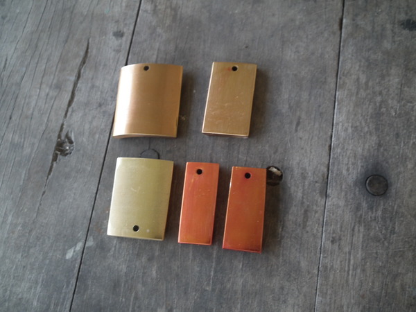

They seemed OK, a couple of slight blemishes but they were multiple colors - the darker gold is green over red dye, the lighter gold is red over green dye and the rum color is violet over gold dye.
