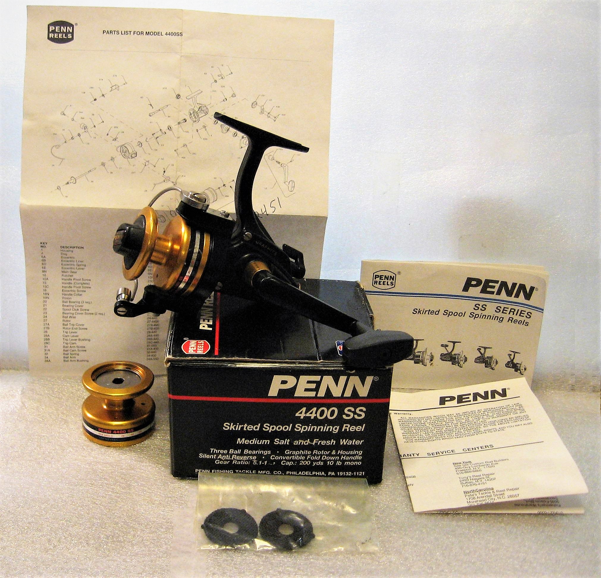

Big surprise!   :o   I just stumbled upon a like new Penn 4400ss in the box with the manual, schematic, extra spool and extra set of drag washers today for a price so good I couldn't pass it up.  8)  It took me about 30 seconds to gobble it up.  ;D

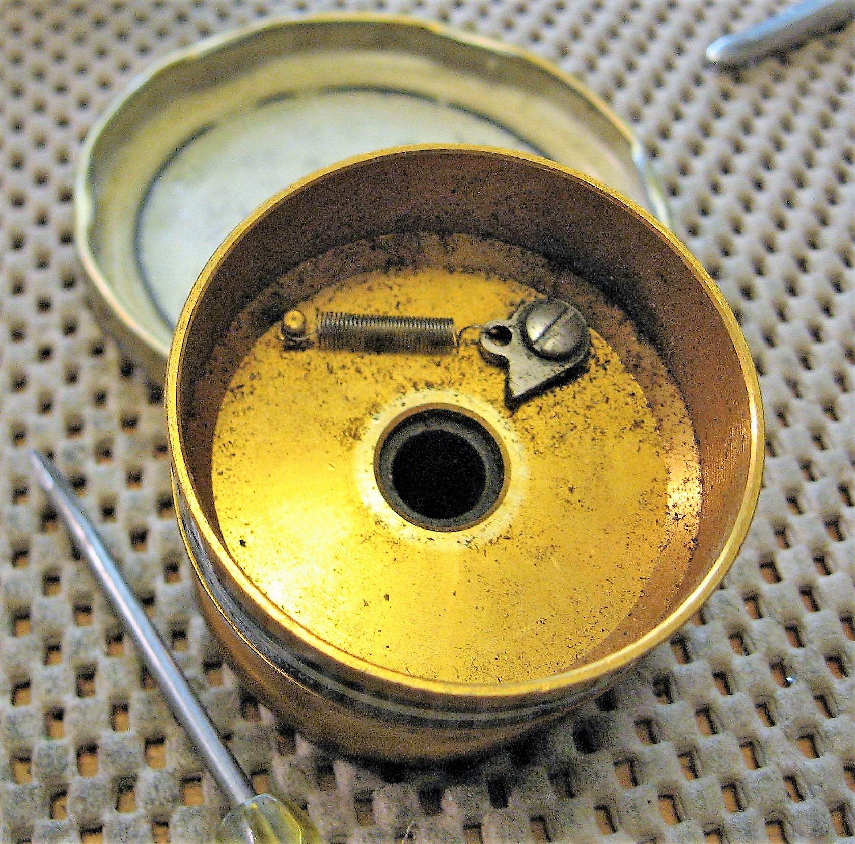

I took a pic of the spool click setup for later reference. The spool was kind of dirty.  ;)

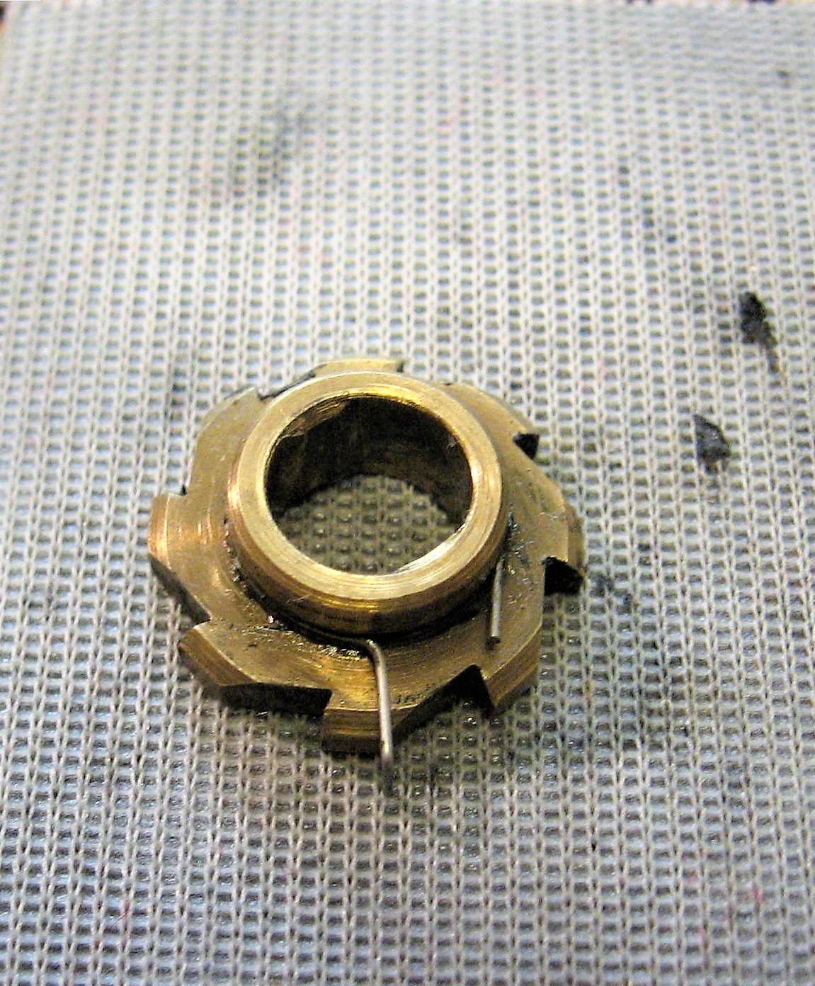

Here's a photo of the back side of the anti-reverse ratchet gear. The spring that activates the A/R dawg rests in a groove. The spring has a bend on one end that goes in the slot in the A/R dawg. That is what activates the anti-reverse. You can see it in the above photo.

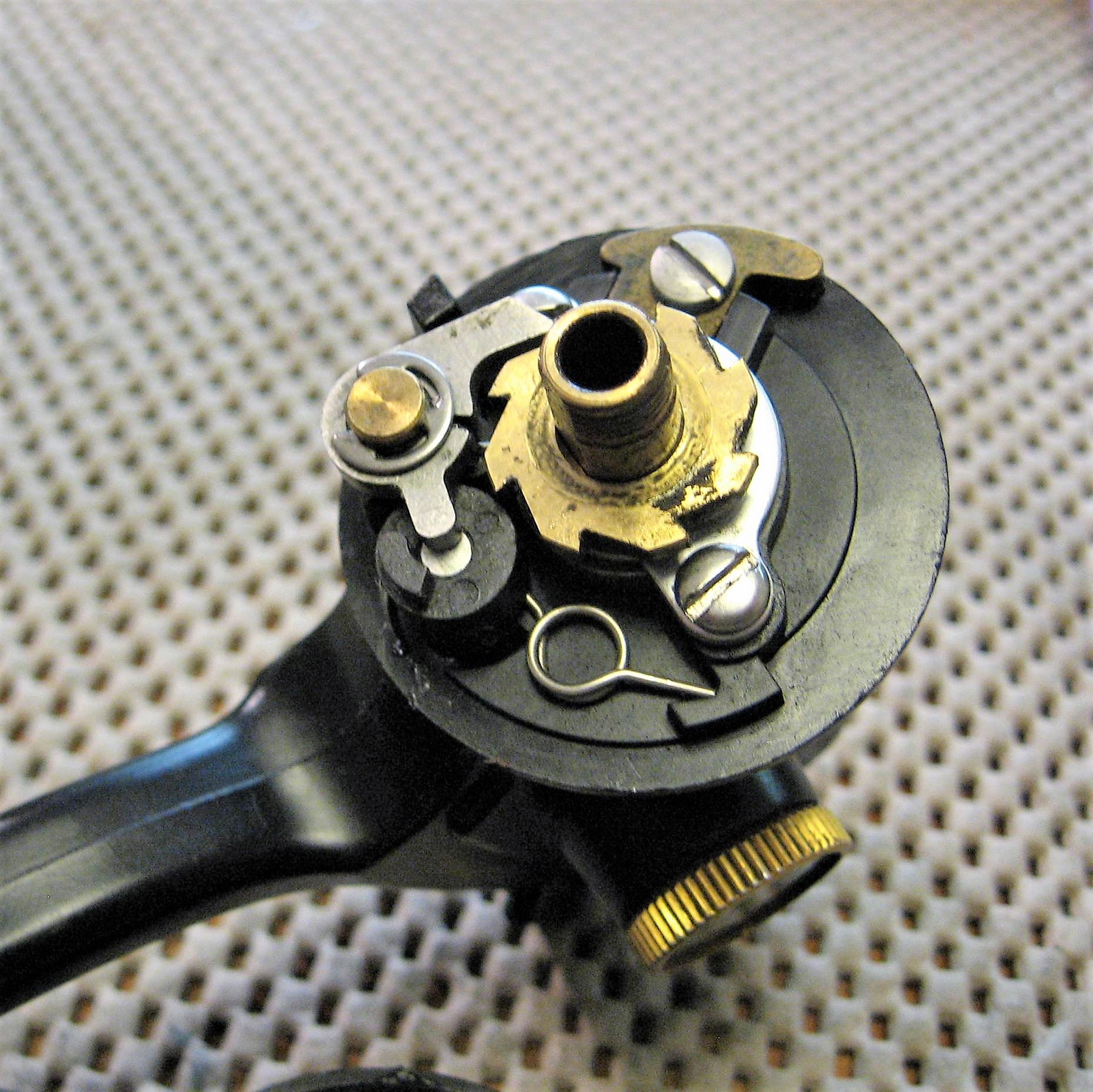

I took a couple of photos of the bail screws because the shiny plated screw goes on the bail spring side and the brushed satin finish screw goes on the bail trip lever/line roller side.

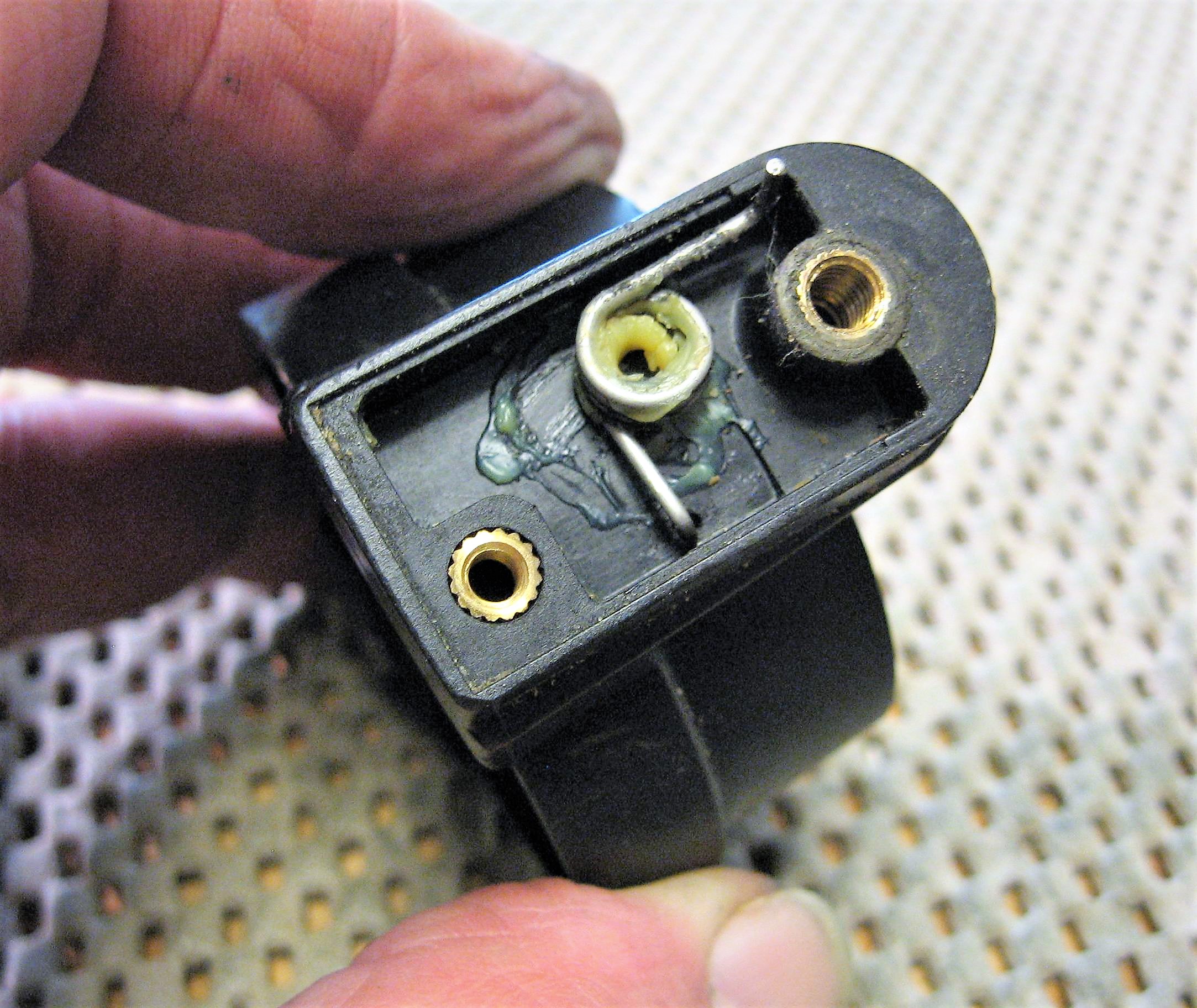

The long leg of the bail spring goes into the hole in bail plate & short side goes into the rotor. The bail spring had originally been greased. I don't grease bail springs so the grease was removed and I lubed it with ArmorAll when I reinstalled it.

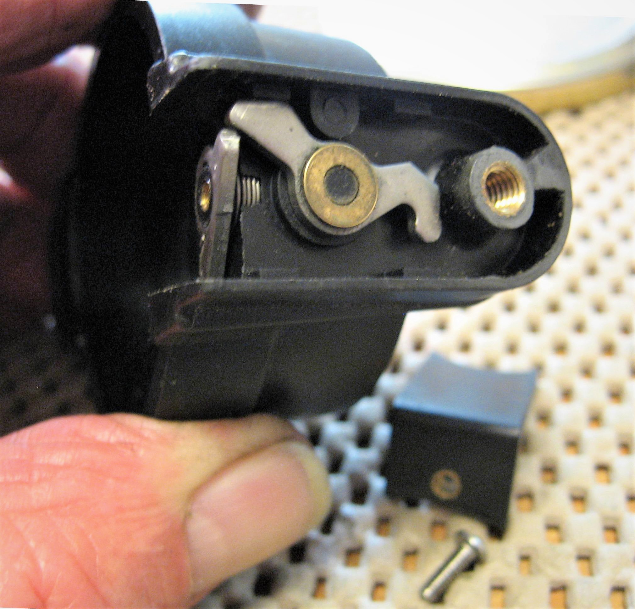

I took a photo of the bail trip configuration because there's a small spring under the trip lever that has to be installed correctly for the bail trip to function correctly.

Here's the finished product, box papers & all.  :D
