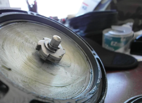

As Boon's described, it's a mechanical AR/lock operated from the clicker side, ie:
(Pic courtesy of Wolli's post on 2000NRHG Maintenance - ignore the red arrow...)
Once actuated, the spool will only turn in one direction (ie retrieve).
It's effectively a gear saver when you're trying to intentionally break off a trapped jig...

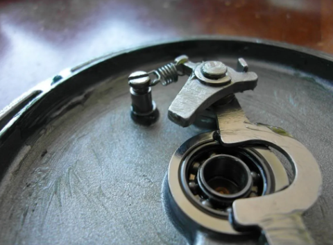

redsetta
A couple more pics of the mechanism, if of interest:
nelz
Ok, so if I'm seeing this correctly, it does prevent line from going out, as in a locked-down drag (except it's by-passing the drag completely), but you can still reel in.
