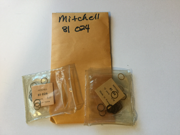

Hi G --
Mike is right -- M&C should have these.
But the right thickness and specs are critical on these old Mitchells -- and it might be kind of expensive for just 3 spacers for shipping.
If you have not made arrangements yet, and could use 3 (Mitchell recommends 1-3, as needed) just PM your address and mailing information -- and I will send some out at N/C.
These are the shims for the Pinion, Body, under Rotor assembly -- to take out the roughness for better gear alignment on the pinion.
There are also shims for under the baffle plate, if this is what you need.  Have those too.
