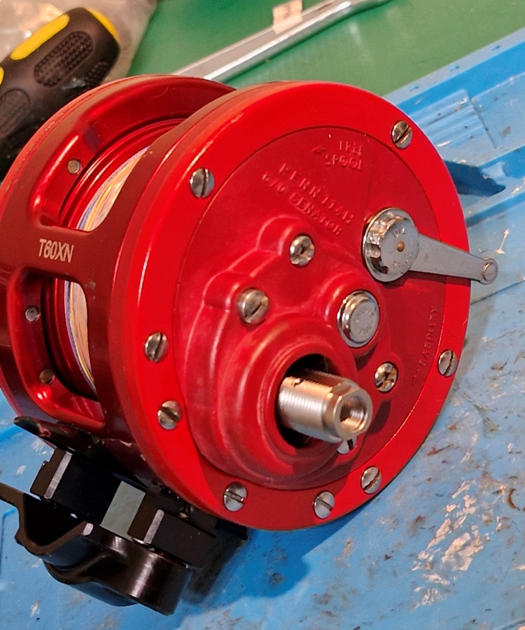

well, Its my time to built the bigger bro of my T4N1 reel, the big old 114h XN, I couldnt have the kit when Randy offered years ago but lucky me was on the time and place to grab the one my compadre Gregg put on sale some weeks ago.
I have a donor 114h reel which is missing the spool and half frame that I never cared to build it back until getting that tiburon XN kit recently, then got some SS parts and the drag upgrade pack from Jason as this one https://alantani.com/index.php/topic,37574.0.html
the rings that came on the donor reel were to ugly with some corrosion, so I sanded them and painted them bright red with 3 final coats of spray urethane, pretty sure it wont hold but even when they got scratched and missing spots of paint will look 3x better than how they were before  ^-^ and I can always take them out and install the shiny ones that Jason sent me along the SS parts.
I have two brass dogs and used them to help me to cut the sideplate to adapt a second dog, but I will order some SS 114 dogs from mystic in few days, I liked the sound of non-syncro dogs but still dont know if I will installed syncro or non-syncro dogs when finally got the SS dogs.
the think I need to order before build the reel and I havent found where to get it is the Eccentric Jack, the one that come with the donor reel has the "legs" just bent but Im looking for the reinforced Jack, on Mystic parts the part 11-114 shows a picture of the old style jack not the reinforced one, I dont know if thats the one they send or the reinforced one and just never updated that picture
this an old post from Sal where he recommend to use the reinforced Jack with beefer tabs
so, still missing to finish the reel although I have the stock parts to build it but Im not in a hurry.
- 2 SS dogs
- Reinforced Eccentric Jack
- take the 80# braid out and install 100# braid on it, its better here for abrasion purposes to use heavy braid line

Those red rings are unusual looking. But it's kinda cool I like it. Happy to have contributed.
Quote from: JasonGotaProblem on February 24, 2024, 02:13:23 AMThose red rings are unusual looking. But it's kinda cool I like it. Happy to have contributed.
thanks to you amigo
agree on the rings, I might do something similar to my 113hXN reel  ::)  ::)
The T60XN lives on! As the "Red Grouper"... Nice work Alex, I like that red ring look.

The Penn rings are brass.  They cannot be anodized. Powder coating is the preferred method if you want colors.  You usually need to blast off all the old chrome first.
I have  done a bit for myself and for a few other members that spoke kindly of my home state of  California  8) .  Not too tricky, but does require some equipment.  Powder coating services are usually not too hard to find here, as the process doesn't involve toxic chemicals.

Steve, well I dont know any places that can do the anodizing or chrome plating, I did painted the rings as experiment and I liked but I will use the rings and I will think on powder coating them when I saw them with lots of scratches and with tons of spots missing paint

WOW! That is one gorgeous red reel. Hope to see the finished product soon. Any luck finding a reinforced eccentric jack?
