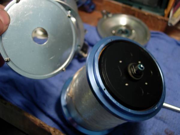

off comes the spool cap.

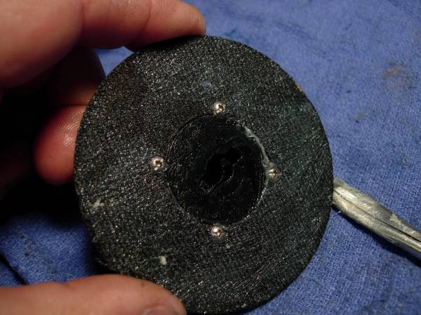

this reveals the back of the drag pressure plate.
here is the working side of the same pressure plate.  i do not know what kind of material this is.  it's obviously not carbon fiber.  some gummy material from this drag washer had also transferred over to the stainless steel drag plate.

and the drag pressure plate.  you can see better in this photo some of the gummy drag material that has rubbed off from the drag washer onto the pressure plate.

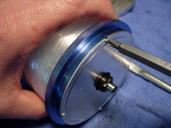

the drag plate goes back on.  take the time now to grease the screw holes for the spool cover.
note the rubber gasket.  just like shimano and okuma reels, the drag chamber of this reel is sealed off by this gasket when the reel is in gear.  leave the drag lever of this reel, the shimano and the okuma, in the strike position when you hose off the reel.  this will keep water out of the drag chamber.
on go the spool cover, the anti-reverse ratched gear and the bearing thrust washer.

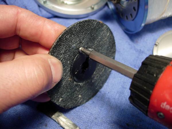

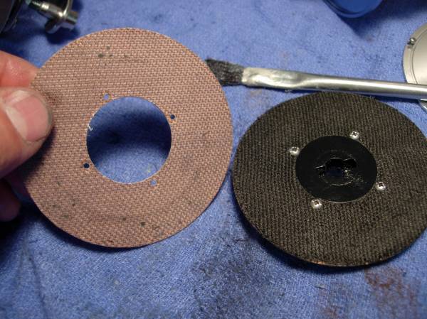

here's a follow up.  with dale's help, i finally got the right drag washer after ordering up the wrong one first.  it's the drag washer from the shimano tiagra 30.  yup, the reel is nearly an exact copy.
here's the stock drag washer.  yeeccchhh!

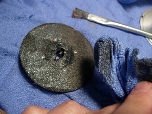

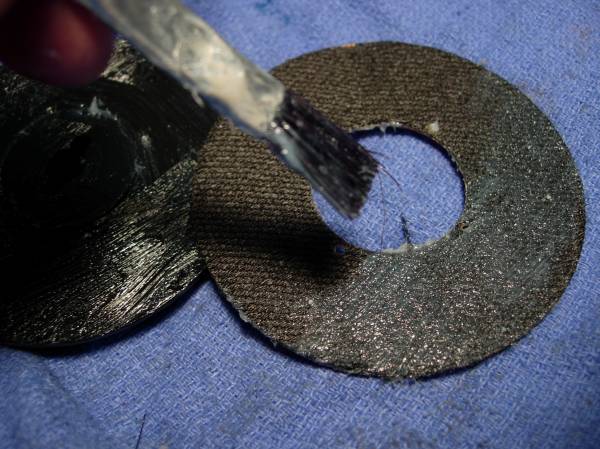

i pulled off the old drag washer and found that the tiagra 30 washer was a perfect fit.  i greased both sides of the new carbon fiber drag washer, as well as the contact surface of the aluminum pressure plate.  i've seen only one drag failure in the tiagra line.  that reel had corrosion underneath drag washer.
even the screw holes matched up!!!!!!!!!!
off came the excess grease.
