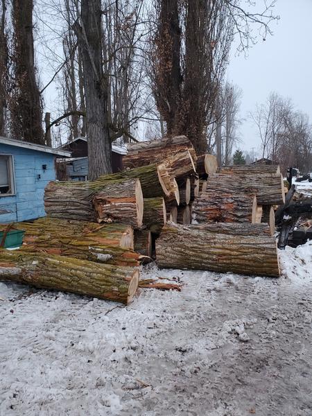

Poulan Wildthing ans Stihl pro but I can not rember the modle.
The Wildtinig is 30 years old and starts every time. It is my branch saw.  The Stihl was used to buck the large poplar trees we had cut down a few years ago.
