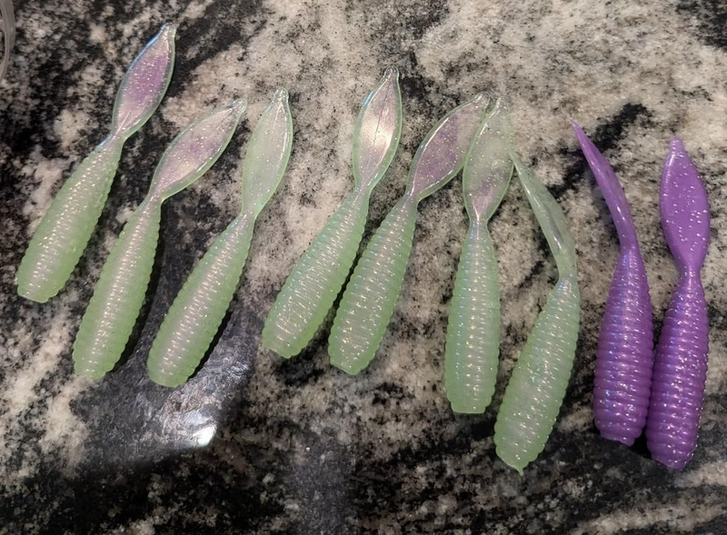

Cooked up some grubs on my lunch break.
Both of these are a lot more opaque than I wanted. Too much chartreuse in the emerald grub and too much junebug in the purple grub. I used three different brands of colorants and the junebug is a lot more concentrated than the other two brands.
I'm also getting a bunch of air bubbles in each grub, not sure what's causing it. Going to look into it more after I get off work.
Edit: Not enough glitter in both baits, too. I'm taking notes on each recipe so I should be able to tweak them to get them how I want with the more baits I pour.

Your grub pours look good!
The air bubbles are introduced whenever you mix or pour.  Some folk use a vacuum chamber to degas the mixture, but I found it was sufficient to rest the plastisol after shaking it up, and then mixing and pouring more gently while it is hot. The bubbles  will eventually rise out as long as the mixture is not too viscous.  A bit of rest before the pour helps, but then you have to heat the plastic a little extra to compensate, which is risky. As long as you don't get a ton of bubbles, it won't affect the integrity, and the fish won't care.  100% bubble free is mostly for impressing other fishermen.

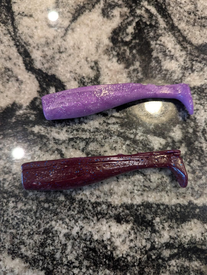

I'd eventually pour 3-4 inch swimbaits. You poured that swimbait? How do you get the top so clean? I thought it was injected.
jurelometer
Quote from: Jighead on May 14, 2026, 06:56:35 PMI'd eventually pour 3-4 inch swimbaits. You poured that swimbait? How do you get the top so clean? I thought it was injected.
Once you do it for a while, you will dial in how much you need to overfill a given open pour mold, so that it is flush when it shrinks and cools.  And only post photos for the ones that come out nice :)  I have a whole bag of tails that only the lingcod are going to see.
Multicolor laminations are a pain.  You have to heat up all the colors separately at the same time and pour quickly so that the bottom layer doesn't cool to much leading to delamination.  Or you can toss the filled mold into your non-food oven and heat the whole thing up for awhile. This works best, but then you are taking 20 minutes or more to cast, heat and then cool a single pour. For people who are trying to make the best looking (to humans) baits, this can be worth it.  Me?  They get chewed up or fed to the rocks too fast for this.
