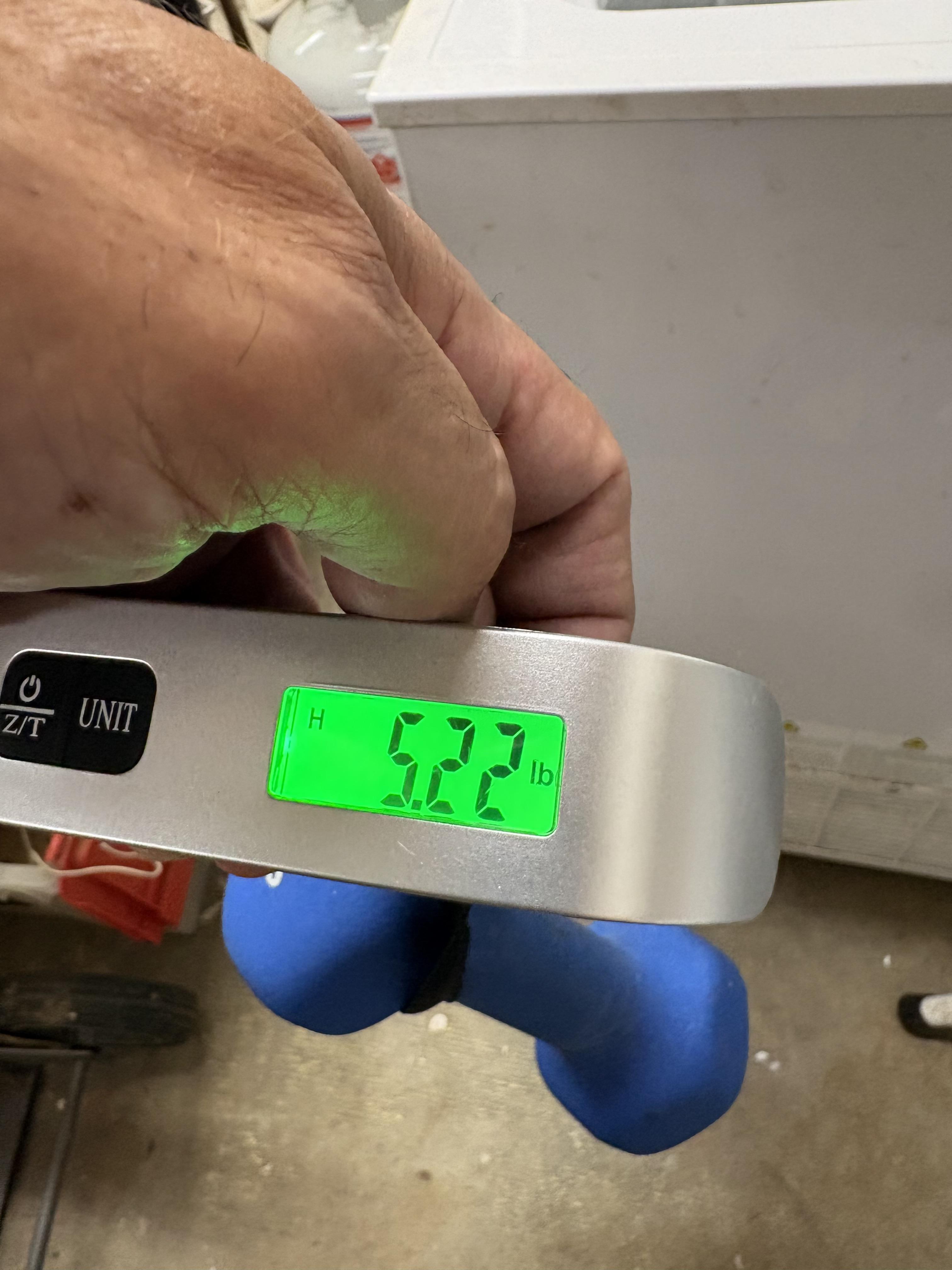

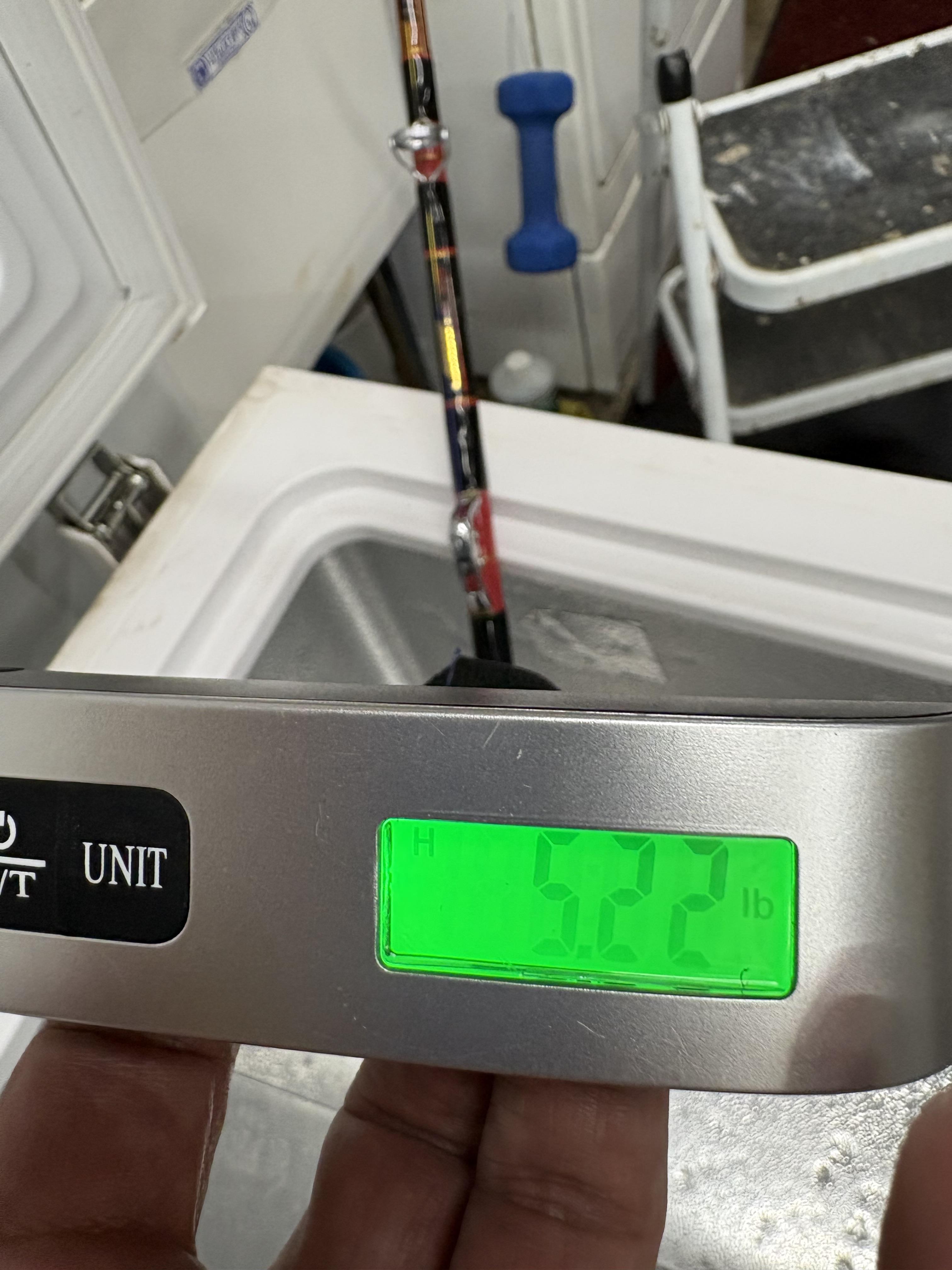

Let me try it this way:   Work = Force * Distance. If your drag is set to 10 lbs coming straight off the reel, and the fish pulls out 10 feet off the reel, that took 100 ft lbs of work leaving the reel (10lbs * 10ft ).
This amount of work will have to take place to pull 10 feet off the reel whether the rod is pointed directly at the fish or at an angle.  So if there is less or more force at the fish side during the pull, then the distance will have to change to make up the difference (Work = Force * Distance).  But the line is not going to allow the distance to change.  10 feet is 10 feet.
I finally realized that I have to either give up or do a demo to prove it.  But the garage is such a mess, if I don't crop the photo carefully, Fred would probably stage an intervention :)
Luckily (?) I had a freezer that just died as I was coming home with a load of chinook and halibut that I caught with  Todd (Hardy Boy).  The freezer made a perfect rod holder for the test, and you can't see the rest of the garage. Winning!!!
First photo- dead lift (same as straightline drag test): 5.22 lbs
Second photo- line through the guides, rod at ~ 45 degrees with a bit of bend but not moving (same as a PROPER angled-rod drag test): 5.22 lbs
