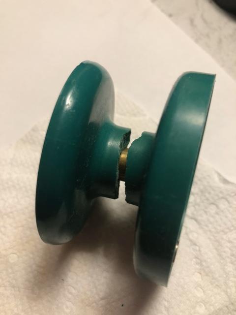

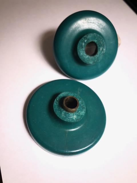

I have two 712 greenies with silver aluminum spools filled with 20 lb. original fused Fireline (dyneema) and a 712Z loaded with 12 lb. pink Ande.  I also have two 710 greenies with empty plastic spools and upgraded with 712 gears. I've never needed to use the 710 greenies since the 712 reels would cover all my "heaviest" spinning needs.  If I ever needed a bigger reel, I could always load up a 710 or, extreme scenario, get my 750ss out of its box, but now days that's unlikely.
It's true a 712 will hold more braid than most people need, but in that vein, it makes more sense to me to fill up a 712 with braid rather than to fill up a 710 with it regardless of what the spool is made of.  But these days my spin fishing is primarily done with a 714 and 14lb. Fireline.
A reel repairman friend in a local fishing/hunting shop gave me the broken plastic 710 spool below.
Example of what monofilament did:
