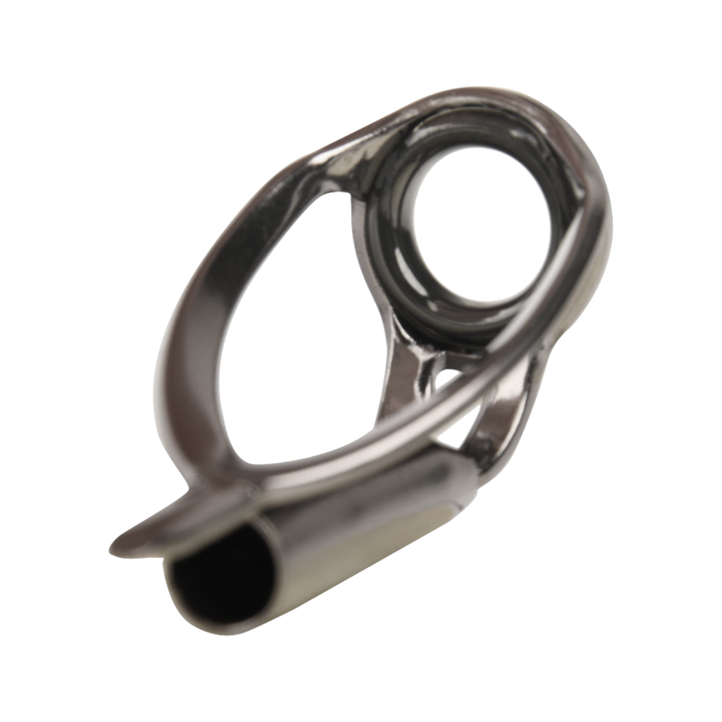

you dont HAVE to install the very same model of tiptop, I would try to find a different rod tiptop model, something more XXH duty, probably some old stock of fuji or Forecast like this one on the picture.
the long tube on those tiptops works better (because you can fit more glue into it) to hold the tip in place than the tang/tongue that need to be wrapped, its not as complicated to install as the stock tiptop and it will support few more mistakes/hits on the deck than the stock tip.
it seems that is not as easy to find as before but asking or looking here and there you can still find them if you want to try them out.
you can go without wrapping any cosmetic thread work on the tip
I try to install those tiptops on loaner rods for local captain's boats.
Forecast "FT"  tiptop on getbitoutdoors
