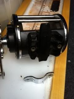

Thanks for all of the quick and helpful replies.
I am going to try and attach a picture of what I have and hopefully it will work.
I have both the Newell base (I guess it is the Newell one from your comments) as well as a non-matching metal bracket piece.  Both a pictured and the holes do appear to match up.
As the holes in the Newell base are threaded, am wondering if I could simply go to the hardware store and pick up a couple of screws that fit?  Any chance I would accidentally damage the Newell base if I did this?  Also, I assume that Newell is like Penn in that I would be looking at standard (not metric) screw thread sizes?

seaeagle2
You are looking for a bolt or a stud.  Mine uses a stud (a bolt with no head) and a nut that tightens up against the base of the reel to hold it tight, then a "nylock" nut under the clamp.  Mine are stainless, and are standard threads. Just take it into the hardware store and match up the threads and you'll be done..

 I would also take the measurement of your rod seat, that would determine the lenght of the bolts. Mount the reel on the rod and hold the clamp in place. You can always cut the bolts down if they're too long, but would be useless if they're too short.

so it sounds like i can just buy a couple of plain screws
as long as they are long enough and the threading matches i should be good to go?

If you go on Ebay & check Newell you will find the screws you need 4/$5 with free shipping from Fla.
You know, you could probably fish that reel without the clamp.
I thought you had a stand similar to the one that I'm showing, you wouldn't have had a choice then.
Your reel should be fished at around 10lb, I believe that you'll get away with it. The 149 desn't come with a rod clamp and is a much heavier reel that is rated at about the same.

Not worried about strength as I just plan to fish 20lb mono on it, but was hoping to mount it on a deckhand wrapped rod with no reel seat, hence the need for a rod clamp.
Just want to confirm again that I can just buy some normal screws and as long as the threads match and they are long enough it will work.
