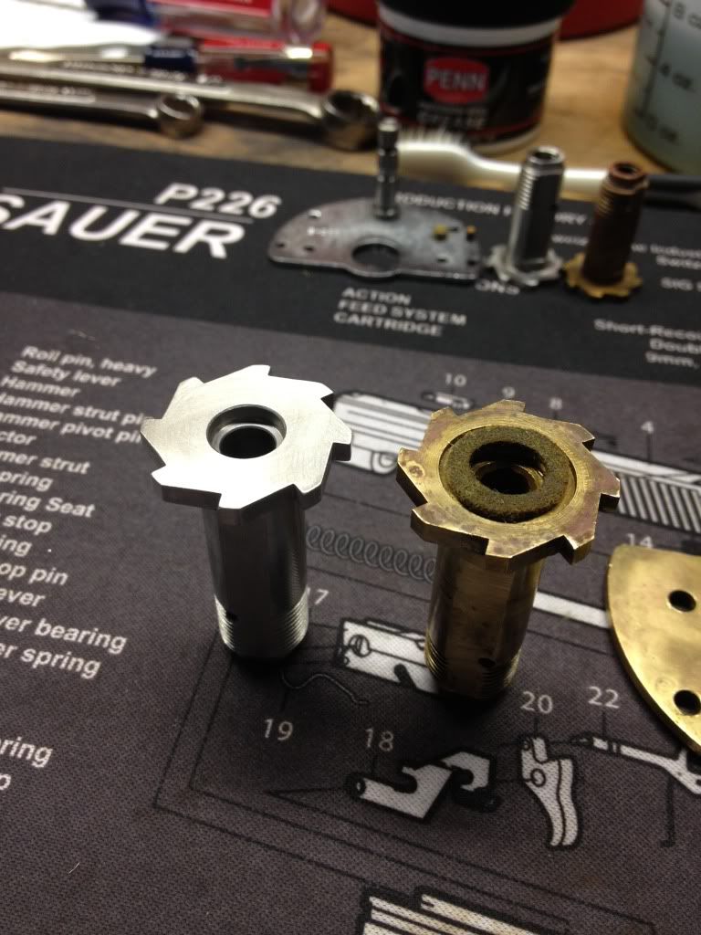

I have an old Senator 9/0 that my grandfather left me and the new stainless gear sleeve I ordered is slightly different.  The old one has a felt washer (see below) and the new one is smooth.  Is the new sleeve supposed to sit metal-on-metal or is there a washer of some sort between.  I don't see anything in the schematic.  Any info would be great.
Welcome number 41. your new sleeve does not need the felt washer, it will sit metal to metal. If the new sleeve happens to have too much play you might need to add a metal washer as I did here:
Enjoy your stay, any other questions....just ask.

number41
Thanks for your quick reply and thanks for the good info.  My grandfather's reel is the older style with the "accessible drag".  My next question is, do you think I should buy a new right side plate so I don't have to use a 50+ year old felt washer (part #'s 140 & 136) since they don't sell/make them anymore.  Again, your help/advice is really appreciated.
You will not need a new right side plate.  The new HT-100 set of drag washers plus the metal drag washers are a direct fit.
