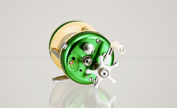

found one!  looks pretty simple.
Drisse
Yes, I know it looks simple, but it quite complicated inside. To be a reel from the late 50:s its very impressive inside.
No rocket science, but I failed to rebuild it a couple of times now. To many really tiny parts in this one.
So the best would be if any skilled person who owns a Arjon Fighter could take a couple of pictures :)
You have to agree Alan, its a beutiful reel.
Irish Jigger
Is there a lever/knob missing from that reel?
reelgood
this guy might be able to help you.  what are the 4 holes on the left sideplate for?  The red paddlewheel is the clicker?
http://orca-online.org/reel-talk/viewtopic.php?t=10221
Robert Janssen
There are no knobs or levers missing.
The holes in the left sideplate are to facilitate air flow across the red paddle wheel of the pneumatic cast control.
the reel is more intricate than what it may appear, not leastly by way of Arjon's solution to the age-old riddle of the levelwind problem: Levelwinds are good to have on the retrieve, but are in the way of the line during the cast.
Arjon solved this by making a mechanism wherein the two sides of the levelwind window split apart and move away to either side as the clutch release button is depressed.
This feature was shared with the Arjon Commander, which also featured an automatic clutch mechanism for casting. No idea how that worked.
Disse, ABU used a functionally similar levelwind many years later on the Ultra Mag or Mag series. Maybe you can find food for thought by looking at that.
