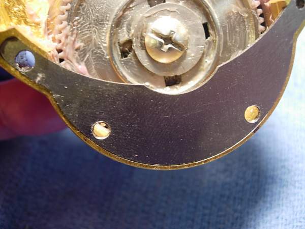

I always open my reels to see what makes it tick and this was no exception.

the main body has a flanged bearing inside so there is no need pulling it out from the inside. This bearing is ofcourse packed with grease.

the main gear assembly is made of stainless steel
once you remove the handle and it's assembly assembly you can push out the whole main gear shaft and main gear. two washers, a rubber seal from prevention intrusion into the anti reverse bearing and the two other bearings and a felt washer (pretty much the same system as a JM reel, it gives very light cranking and winding and is very stable with no play at all.
once the main gear assembly is out you get to access the right side plate bearing and a look into the anti reverse bearing from INA germany, this bearing is also used in alutecnos and JM reels and alot more high end reels. Now a big surprise for me was that they use a angular contact bearing. this is superstrong against sideloads (when the inner diameter bearing gets pressure once the drag is engaged many right side plate bearing gets crushed. happened to my JM pe 4 three times already!!!)
