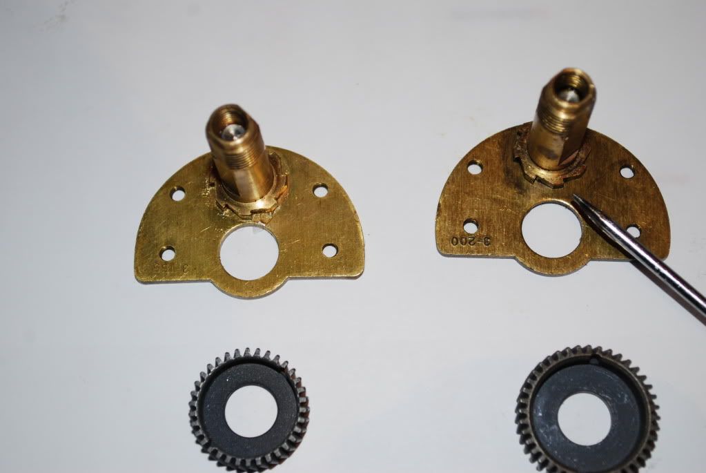

I have a few questions about a 505HS I'm working on right now. First is as you may be able to tell from the below picture that there are two beveled or sping washers at the end to the right. Is this correct? Second is if I was to drill out the opening in the side cover to place a larger and thicker diameter spacer sleeve(9-60 or 9-99) wouldn't this basically give a larger surface area to make contact with the drag washers therefore upping the drag t a couple of pounds? Any thoughts?The part in the top right would be the alum. Pipe to make a spacer.
Unless you are bending the metal washers the contact area of the spacer sleeve does not matter.  The schematic only shows one spring washer.
As Keta ( Lee ) mentioned, you should have one cupped washer. Do not drill the opening, it won't help you.
A cupped washer spring is used to evenly distribute pressure on your drag stack. There are a few things you could do to bring the feel of the drag tension to your liking, you could add another keyed washer under the cupped washer...if you have the room. I like to add this washer right under the star wheel:

the bellevilles on the lower right should distribute downward pressure onto the top keyed metal washer properly.  the small sleeve originally in the reel should be all that is needed.  i think you will be fine without the larger sleeve.  put it together as is and run it through its paces.  i think you will be fine.
