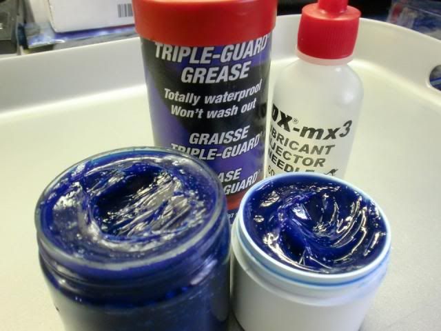

Quote from: Bryan Young on March 13, 2013, 07:33:25 AMSo far, I have mixed mostly corrosionX with evinrude triple guard with good results.
I'm also cutting the triple guard marine grease, though, I'm cutting it with Inox-MX3. So far I too have had good results with it.
In the below pic, the pot on the left is lightly cut with Inox-MX3 to lighten the tackiness. It makes applying to side plates and moving parts more manageable when using a brush compared to when the grease is used 'neat' straight from the 16oz cartridge. Even though the pot on the left is 'lightly cut', the grease is still too high a viscosity to add to non spool bearings and gears teeth, hence the mixture in the white pot on the right. I've cut this with a lot more Inox oil and this mixture is specifically used for non spool bearings and gears teeth. You can see it has more of a shine to it and is marginally brighter in colour to the left hand pot.
How I mix: I gradually add Inox-MX3 to the grease which has already been spooned into a small jar/pot. Now I mix it together and continue to add more Inox until I start to 'feel' the mixture is getting to the consistency I like. Tbh, you'll know when to stop adding oil before you go too far. If you do go too far, just add a little more grease. ;)
As for mixing two different greases together; I've personally not tried it - or should I say, I haven't felt the need to.  :-\
