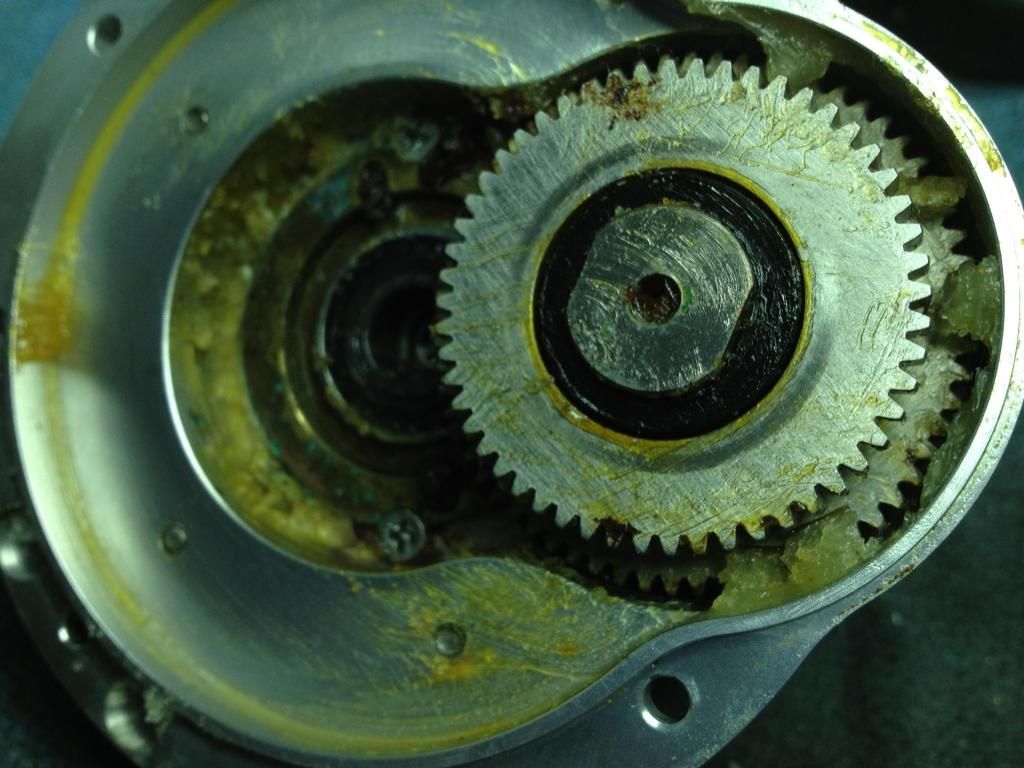

The 320s are fairly simple.  If these are your go to reels, I would also recommend extra idler gears (#64-320).  These are the gears that connect between your spool and your line winder that is intended to break should your finger or anything gets caught between the line guide and the frame...in fact, I wish I had a few right now.
