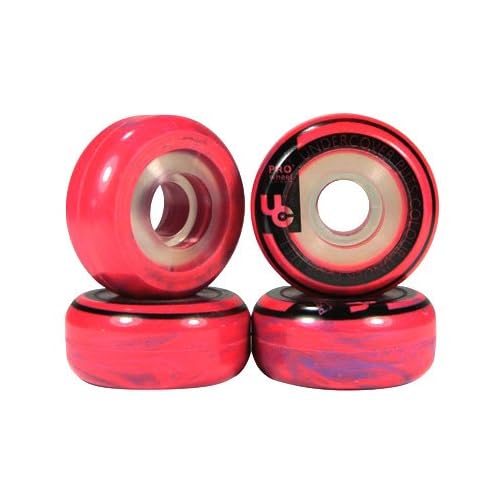

I'm also thinking of the spindle/axle construction. I've never reversed engineered some of the custom handles that are out there so I don't know whats the best approach. But I was looking at my son's skateboard wheel yesterday and looked how it was attached to the axle. And I thought to myself, if you scale that down a bit it could work!
Hey, I even think that on bigger reels a skateboard wheel would make an excellent handle knob!
