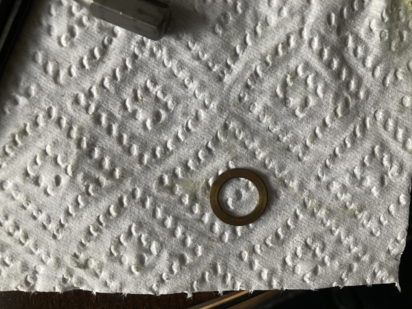

I finally pull the trigger and bought a clean looking 100 at reasonable price from the bay and bought one of Alan's topless frames and he was kind enough to throw in new thicker bellfivue washers. When I opened the reel I found a brass washer floating around in the handle side like the guy who serviced it didn't know where it went so he just threw it in there
I pulled the spool assembly apart, cleaned the bearings and installed the cf drags. From the tutorial the brass washer that was floating around goes between the bellfivues and the spool bearing so that's what I did. With it set up like that the spool won't spin on the spool shaft at all so I took it out and it spins fine. My question is do I need that washer there?  It shows it in the tutorial plain as day but I can't get it it to work that way. Without it the pressure looks like it's on the inside race of the bearing, with it the pressure is on the outside    Seems like that can't be right
I'm thinking the guy before me ran into the same problem so just left it inside so it wouldn't get lost?
Otherwise smooth sailing and the reel works great, just don't want to crunch a bearing. I have another stock one with the level wind that's been a great reel and doesn't  have the same issue
Thanks in advance
Here's a picture of the washer
the two thicker bellevilles replace the pair of thinner bellevilles and this thrust washer.
I'm not sure what the size of that washer is.
If it's a little large, I believe there is a thrush washer under the handle chrome cap that sits under the handle.
crud.....  i think you're right!!!!!
It's just like the picture in the tutorial. Too small for under the handle
if the ID is same as the spool shaft, then Alan is right.  Thrust washer that is normally installed with the stock belleville washers.
