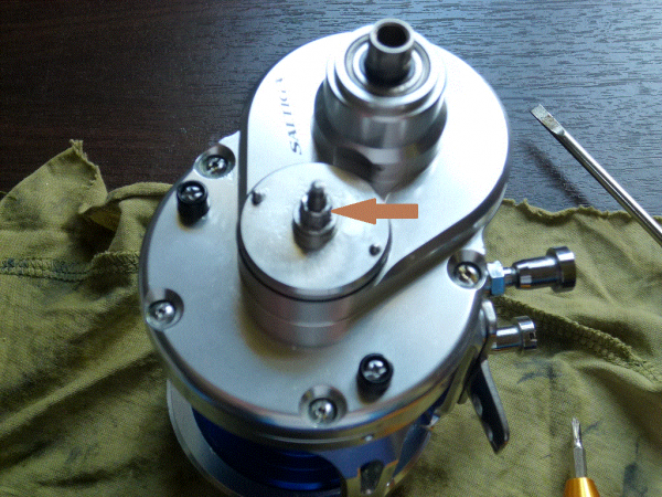

Hi Dave here are some diawa dog pictures. the alum plate is milled with a 4 fluted end mill. the 2nd dog was modified to use the coil spring,
  these should give you an idea, but write me, love to help, gst.

I like that approach to adding the 2nd dog . . . Why was the Main Gear being milled ?
doradoben
gstours, I'm not very familiar with machine shop procedures, are you using a drill press to mill the drag washer reliefs in the main gear ?
Robert Janssen
Quote
Yes, it looks like it, using a plunge action in small increments / depth of cut so as to not upset the inherent non-rigidity of the drill press and chuck. That'll work, if done very carefully. Indexing looks like it is done with a careful eyeball measurement.
I like the repeatability of the drywall screw located jig! Whatever gets it done, he's done amazing things to his reels.
