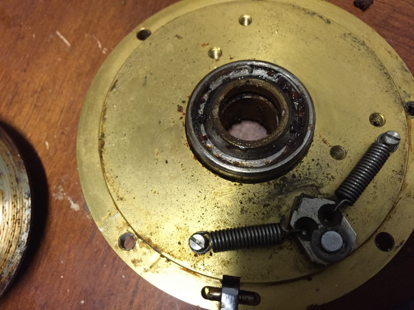

Hey this is my first post on this website. Amazing info already thanks a lot for helping me service my reels. I have a classic gladiator 4/0 that I used the schematic above to help me out and for some reason the reel is still not functioning properly. I think I have a problem with a brass ring and which direction it should be facing, my fault for not taking a picture or remembering. The first time I put it together, everything worked but the handle would get harder to crank the more drag pressure was on. Now the when the drag turns, the handle turns with it. The anti-reverse must not be engaged for some reason. I will try and post some pictures of the inside below. I hope I get this reel running, cought some small makos with it last year before it started acting screwy, it needed to be looked at. Thanks!

Never mind folks, had the anti reverse backwards. Duh. Pumped on using his reel for another 50 years!
