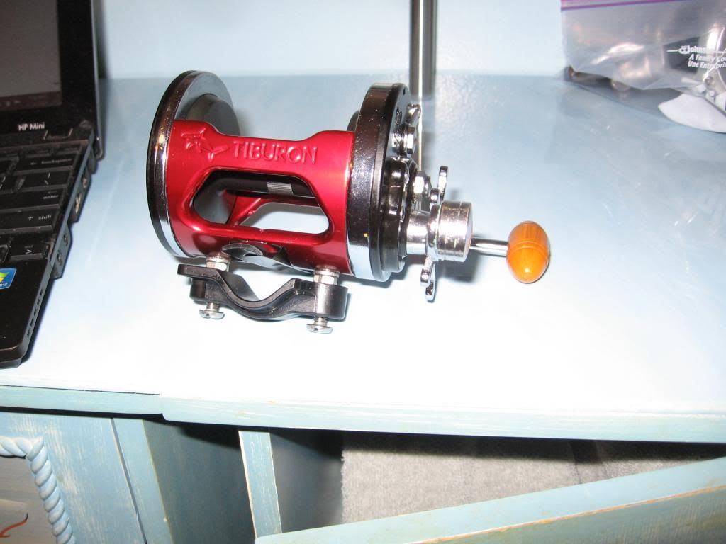

I also heard of the problem with the clamp Hoyt. I emailed Tiburon and they sent me one free when I told them I bought it from Alan Tani Himself! It was on a surfmaster 200. Fits perfect now! ;D
