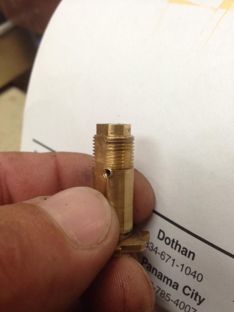

After further inspection.
My star is not striped like as bad as i thought.It will still screw on to my brass sleeve fine.As you can see in the pic the threads of the stainlees sleeve are bad.They are very rough and not deep enough.
as you can see the threads on the brass sleave look fine.
I can scew the star on it fairly easy.
heres the star.This was a new  stainless sleeve that i installed i noticed when i first put it on that the threads were not that smooth but thought it would be fine.My best guess is that they werenot cut deep enough.Yall's thoughts?

wow!!!!!!!!  that is definitely one of my gear sleeves!!!!!! before i send them out, i look at each one.  the damage to this is so obvious that there is no way it could have left the house looking like that.  if it came to you like this, the damage had to happen AFTER it left here.  i'm not even sure that a coarse thread gear sleeve could do that amount of damage.  it looks almost like someone had a coarse thread stainless steel star and tried to force it onto this fine thread stainless steel gear sleeve.  a brass star would have been soft enough that the stainless steel threads should have survived.  i am still sending you a 10-505 fine thread star.
That's exactly what I thought when I first saw it. That sleeve was not made as shown, each thread is cut in the middle, something had to do it.  I also believe it had to be a fine threat stainless star, couldn't be anything else :-\.

I got the gear sleeve from OCD reel service. Which is Mr. Kieth he is handi2
Here on the site. I noticed when I got the sleeve the threads were kind
Of rough but not like they are now. I was checking the drag on it Friday
Night and was not getting but 6 # of drag with new carbontex drags 3+1 set
I wanted to see what my max drag was because I had one of Bryan's kit
To install in it and wanted to compare numbers. I tighten the drag down
Got 6 # and that was all. Tried to lock it down and that's when it striped out.
This gear we've had been in there 2 weeks been fished once in fresh water
I am a mechanic and welder by trade. It looks to me like the threads were
To shallow and they were brittle. Not blaming anybody I think it was just
Bad luck on my part.
