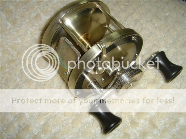

mhc
Quote from: Rothmar2 on May 28, 2015, 08:25:25 PM
Thanks for posting those photos Mike. Sweet looking little reels.
Those handles make them look pretty tough. Are they Kolekar's from Alan T?
Have you put Alan C internals in them by chance?
No problem Chris, you did all the work.
The handle on the 500 is an Alan T SS arm and 3/0 Kolekar grip, the handle on the 501 is a stock 24/56 from Scott's or Alan T.
Yes they both have Alan C SS double dog bridge, yoke, jack, 5:1 SS gear sets and the SS spacer bars on the 501. Alan T SS 98-505 gear sleeves on both & the spool on the 500 is stainless - all we need is a SS stand and star.
Michael
