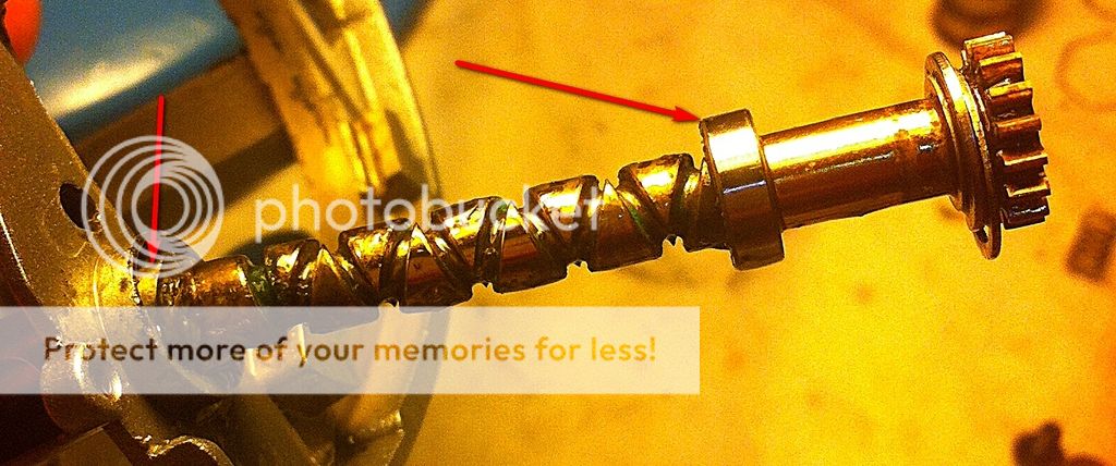

That Worm Shaft bearing sure stuck well to the frame as well, thought I was going for round #2 there for a while. Luckily it popped out after some kind words and a not-so-kind pull. :D
Now the Revo is in bits! Feels great. I'm gonna rinse the reel housing to make sure all of those micro sand grains will be gone once I start putting the reel back together. Or maybe I should just send it all back to the owner in a plastic bag..  8)

johndtuttle
How about that last bearing, still functional?
Jon_Kol
Quote from: johndtuttle on August 29, 2015, 10:31:03 PM
You mean the ones on the Worm Shaft? No, they're gone. At least one of them.. feels like a grinder when I turn it.
Looks like they're able to function as fishing weights!

Jon_Kol
Do any of you know if these bearings are pressed on? They are extremely tight, haven't gotten around to really work with them yet, but they seem to have a very tight fit to the Worm Sharft.
like all reel bearings, it should be a slip fit.   :-\
johndtuttle
Jon_Kol
Gaaah I feared those answers. :D Guess it's back to pulling and turning again..
Quote from: Jon_Kol on September 01, 2015, 06:22:17 PM
You need to get yourself a small bearing puller.

Jon_Kol
Quote from: Reel 224 on September 01, 2015, 08:08:16 PM
Joe
Never thought about that, actually. Can you recommend a version which handles the sort of bearings that we reel-heads often encounter? :)
