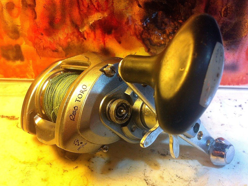

Just thought I'd give you a quick update on this reel. Yesterday, I sent it by mail to the owner. I was handed this reel at the start of August, so it's taken a while.
All in all, this is what was replaced:
* Star Wheel drive (the threads were busted)
* Clicker Spring + Clicker Spring Holder (corroded to pieces)
* Kick Lever - was snapped off (thanks to Alan Tani, who sent me the last one he had for this kind of reel)
* Replaced the drag washers with Carbontex via Smooth Drag
* Replaced the bearing situated beneath the Main Gear Shaft (all the other bearings were good!! :O)
* Spool Break Cap
That's about it, I guess. Here's a few of the maaaany pictures I took during the service.
Here's how it looked after the job was done:
It was really nice getting this reel to function again, and a happy owner is looking forward to using it again come spring 2016. These days my tables are full of reels, so it's out with one reel, in with the next. :)
