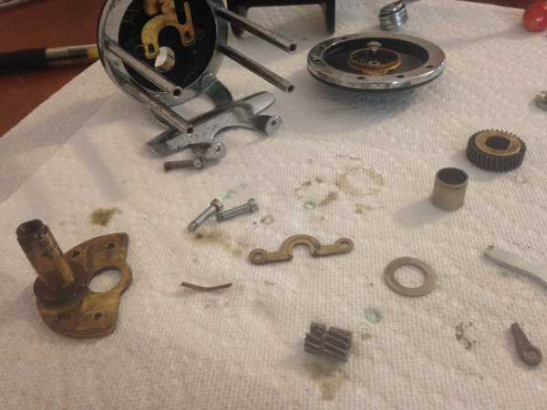

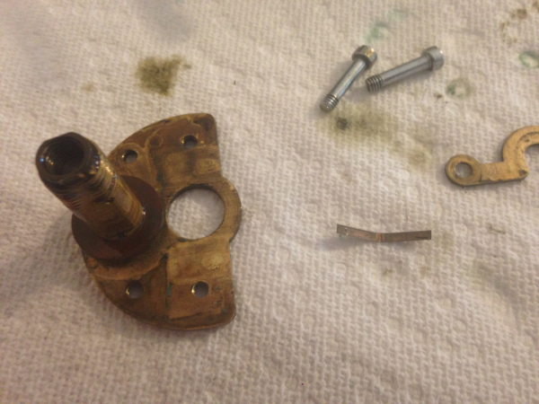

Just tore it down. Not exactly sure what to look for. The little copper/brass? Piece popped out when I loosened the last screw. It looks pretty clean. I did oil it up a few weeks ago without taking it down. The drag washers all look pretty good.
JDM.....it's too late, no going back, you are gonna end up like the rest of us, brushing your teeth with the same tooth brush you use for cleaning old reels, fingers stained with grease..... ;D welcome to fishing reel repair, commonly called the dark side......the flat slightly bent brass piece is the anti reverse dog spring and the triangle piece with the hole in the last picture is the anti reverse dog.  During reassembly the spring will need to be inserted in a way as to apply pressure against the dog to engage the toothed end of the gear sleeve.  This link to the 116 Senator, even though much bigger will give you a step by step process....good luck and welcome to the dark side....Bill

Having an issue, can't get the eccentric back in. What do I do? Found a decent video on YouTube with a 155L but it's not very detailed. I also had it all together and the gears weren't turning properly. They all look good. I'm lost.

You are probably engaging the ecc. spring in the notch when dropping the ecc. into the plate & the bottom of the spring is sitting on the step in the plate. Try installing the ecc. with the spring out of the notch until the lever & screw are snugged down. Then using needle nosed pliers twist the spring into the notch. Also the gears will not turn smoothly until the spool & plates are assembled to hold the pinion gear in a straight alighnment.    Rudy
