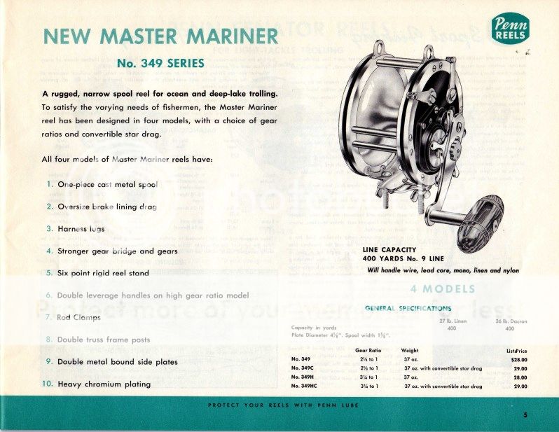

QuoteI have yet to master the differences between models of the 49, 149, 249 and 349C, 349H and 349HC.
That makes two of us.  When you find out, let me know.  I have a couple of 349s but don't know which they are.

  Never fear, the answer you seek is here  :D :D  This image is from catalog 36b. Click on pic for enlarged view :o :o

I'll tell you what I know about the 349's.  The 349 is a 2.3:1 gear ratio and has one freespool lever.  The 349H and 349HC have a 3.25:1 ratio.  The 349H has one lever and the 349HC has two levers which serve the same purpose as those on the 49.  "H" stands for high-speed and "C" stands for convertible.  All of the head plates are marked 349, so you must count the revolutions of the spool to determine if you have the 349 or 349H.
You can easily swap gears in these reels to change it from low to high speed and vice versa.  You can install the slow gears in a two lever head plate and have a 349C, which I believe the factory never produced.  Everyone thoroughly confused?  Good!  Now I'm waiting for someone to come along and correct me. ;)

The 349 was introduced in 1957. It was first introduced in four models. One of them was the 349C.
The 349C was made up to 1961. From 1962 the 349 was only offered in three versions as it is shown on the catalog page posted by Ted. Catalog 36B is a 1976 catalog.

Thanks Mike, like George, I hadn't heard of a '349C'. There appears to be a typo on the catalog page shown, the 4th model is listed as "No. 349C as 349H but with convertible star drag..." and should be No. 349HC as 349H.....

QuoteThanks Mike, like George, I hadn't heard of a '349C'. There appears to be a typo on the catalog page shown, the 4th model is listed as "No. 349C as 349H but with convertible star drag..." and should be No. 349HC as 349H.....
The 1957 Catalog introduction of the 349 was typographically not ready for prime time. They got it straight in 1958 and the four models stayed logically labeled until their final 1961 showing. Here's the 1958 catalog presentation.

 You are right again Mike, the '57 color pocket catalog 349 intro was on page 1, but very little info on each model.
  George, you are right about typo. They got it right on this pocket catalog.
